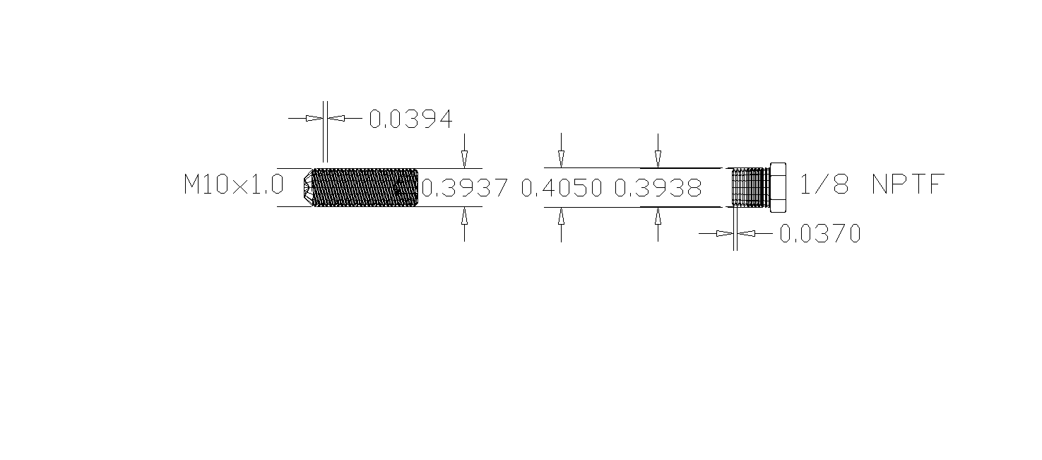

-_- wrote:theirs no need to mod them, its already 1/8'' NPTF( the F is for fuel) which are a little tight on standard NPT taped hole.
10mm x 1.0 mm is not 1/8 NPTF!
"Close to" is not "it is already".
See drawing.
NGK plugs Suzuki DR-250 is 10mm x 1.0 thread size
Here are the spark plug thread diameters and pitch.
M10 x 1.00
M12 x 1.25
M14 x 1.25
M18 x 1.50
See link for spark plug taps.
http://tools.sjdiscounttools.com/spark- ... t-American
10mm x 1.0mm vs 1/8 NPTF
