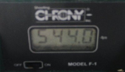

Anyhow, finally decided to take it to 12x - EPIC FAIL :D
The barrel shot out of the suppressor, 30 gram projectile missed the target and slammed directly into the backstop, still haven't found it :roll: still, it managed to register a chrony reading, at 544 feet per second that's a muzzle energy of 304 ft/lbs, by far the most powerful shot I've ever fired from one of my launchers.
