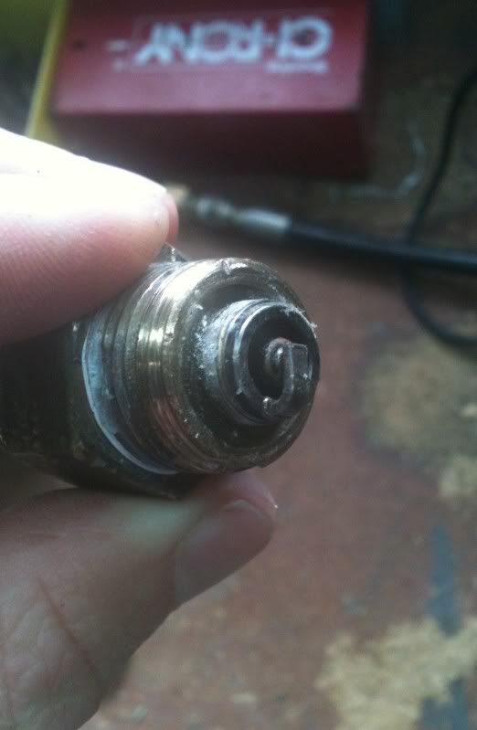

Had some problems with my piston hybrid the last few days. I finally installed a spark plug to replace the home-made electrodes but I was never able to get ignition using the spark plug. I tried on four separate occasions, twice at a 10x mix and twice at an 8x mix.
This seems to rule out electrode gap as a problem as I should have no problem getting ignition at 8x with the gap spacing. There are no leaks in the system and mixing shouldn't be an issue either as I can get ignition with the home-made electrodes (which I put back in) no problem.
I also filled the chamber to 150PSI with air and removed the top wire to the spark plug and held it a small distance from the top terminal. I was getting arcing, which should also imply that the spark gap is adequate.
I think the problem might be due to either the spark plug not protruding as far in to the chamber as the home made electrodes (as well as having a fitting surround it) or it's possibly short circuiting in the spark plug somewhere. Here are some photos:

Yeah, it sparks fine. Also, as I said above, when the chamber is compressed to 150psi, by wiring one stungun wire to the spark plug body (or metal chamber) and holding the other wire ~1cm from the top spark plug electrode (the insulated one), a spark jumping the 1cm gap should be indicative of the spark also jumping the proper spark gap inside the chamber... shouldn't it?.
If you have a cracked insulator you'll still get a spark jumping when you do that.
I would get a new spark plug. The one you have looks pretty worn. Spark plugs will fail at high pressure even if they work OK at atmospheric.
You might also boost the gap a bit. 0.035" (IIRC) is the standard gap for a plug in a 10X full auto. (i.e. a car) using a 30KV or so HV source.

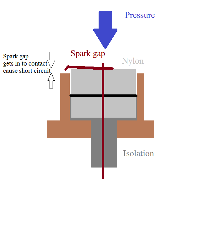

I had a simular problem today with my hybrid, and the problem really shocked me, I will let the diagram to explain.
The result, enlarging the spark gap, the cannon worked wonderfully.
