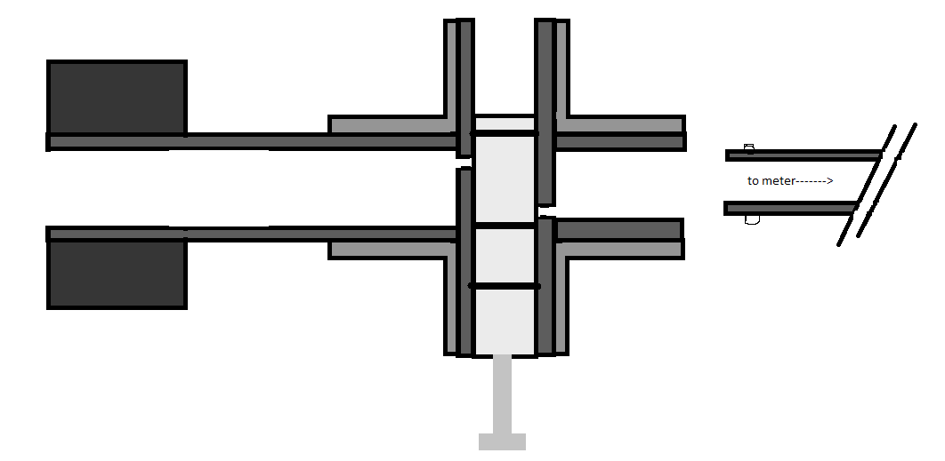

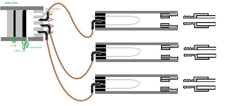

I'm working on a belt fed hybrid, and up to now I planned a spool valve on each cartridge to fill them. That is a lot of work/o-rings/fittings/cost so this is my solution:
Side note:
Would 5 minute epoxy hold these poly, drip line, fittings to pvc?
multiple cartridge fill valve.png (13.77 KiB) Viewed 5299 times
Tue Feb 19, 2013 12:40 am
What do the cartridges look like? And how do they attach to your device?

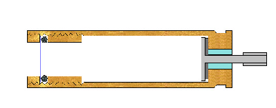

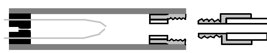

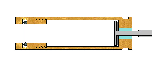

I've already built the cartridge. Cross section below.
Zues:
Good to hear! Guessed that they would handle hybrid pre-mix since they have a small diameter, but I was still unsure.
Did you use the drip fittings?
Does the hose have to be clamped to the barb?
Did you epoxy them in?

I've used the 3/4 hose barb to 3/4 threaded hose fitting, similar to garden tap fittings. I used it for a vacuum pump, and it held until my leaky setup bottomed out at 30mmHG. Then I took it up pretty high, without jubilee clamps on the hose. Not sure how long it'll last without them, but it worked for me.

What kind of a check valve are you using?
Here's a thought:
Say your cartridges are 1" OD and 5 inches long. The easiest thing to do is get a 50 inch long section of 1" ID pipe, pop the cartridges inside and fill the whole pipe with a hybrid mix. Open it up, the mix around the cartridges escapes but that inside the cartridges stays inside because of the check valve. No messing with pipes and connections to fill.

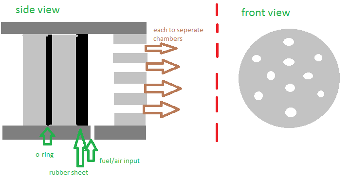

No check valve. The "multiple cartridge fill valve" seal each chamber at the same time. So the drip lines from every cartridge are part of the chamber. The hole from chamber to drip line would be so small the energy would hopefully be dampened.

this was my #1 design, seal is great. didn't like that each cartridge had to indiviually be filled though.

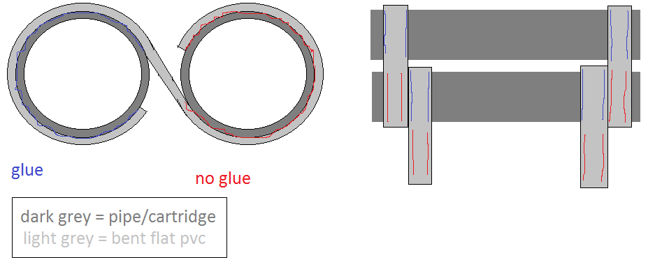

this type of design I tried, however it didn't seal. (it might of been the glue getting on the face...)
flat pvc from pipe heated and flattened (sdr-21 that doesnt fit golf balls)

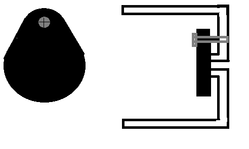

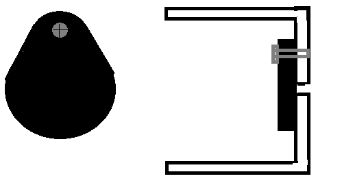

I should take pictures to prove I have in fact tried out several different systems.
I've tried the flap check valve, and it didn't work. I did a lot of searching to find someone who has done it, because I know people have, but can't find anything. Pictured below:
Was thinking it might be necessary to have the flap part seal against another piece of rubber. Rubber on rubber instead of rubber on pvc.
Wed Feb 20, 2013 8:19 am
As with most valves of this type, you need a raised lip for it to work effectively:
