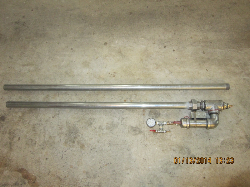

I've been on winter break and there's no better way to spend time and Christmas money than building a hybrid!
Here's some specs for anyone interested.

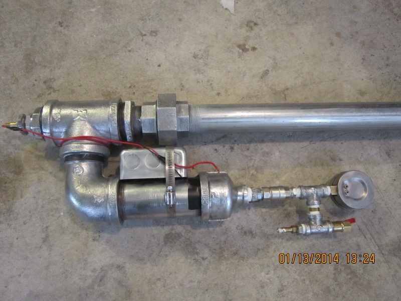

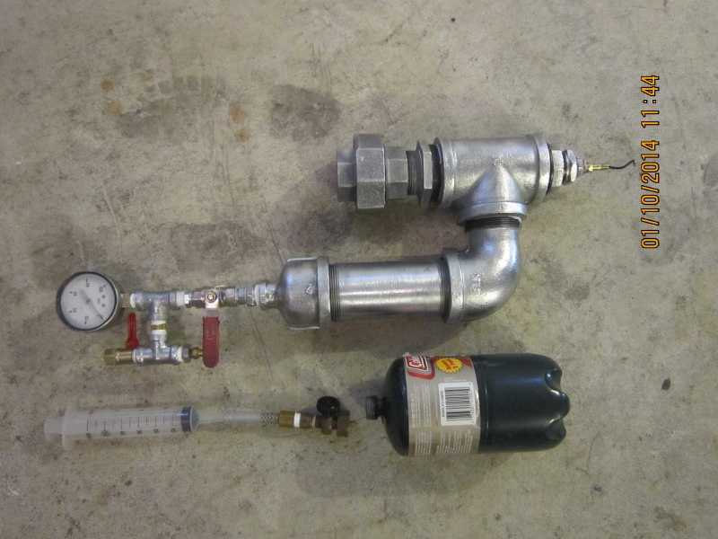

Chamber: 2" galvanized steel, ~1135 mL
Barrel: 1.5" Intermediate Metal Conduit
Ignition: stungun (thanks again Mark!)
Fueling: Inject propane via syringe through 1/4" ball valve

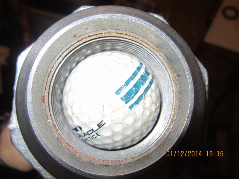

Well I have a nearly unlimited amount of golf balls, and I needed a new golf ball gun due to the first being confiscated by authorities. The first was just a small PVC sprinkler valve gun that could lob the balls a couple hundred yards despite staying around 90 psi. I decided to upgrade.

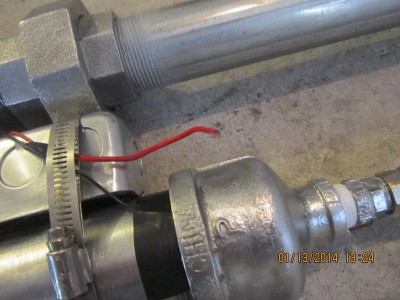

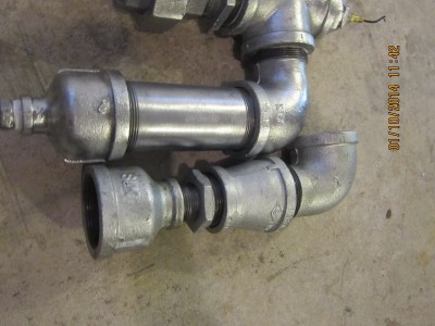

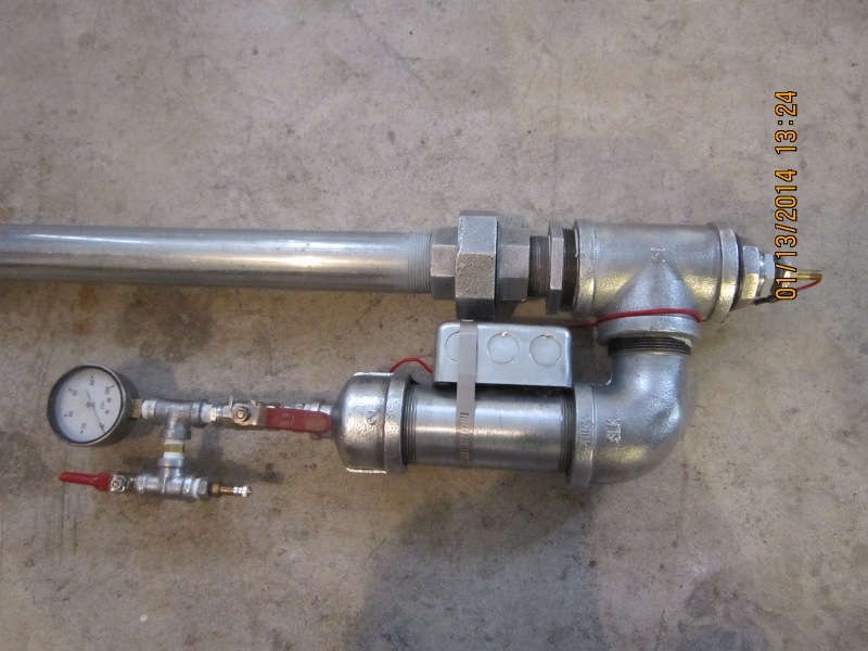

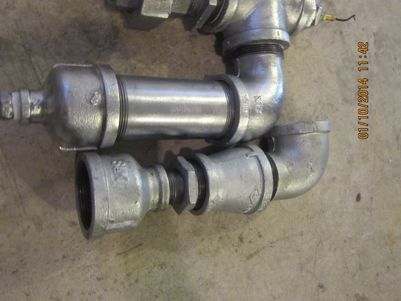

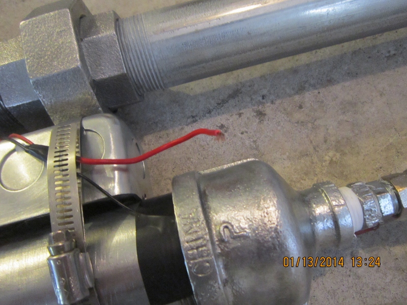

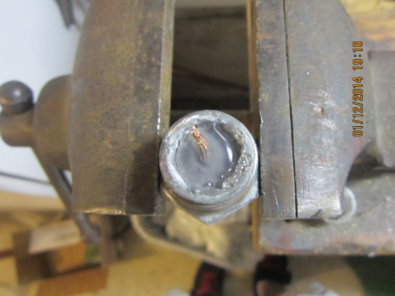

Putting the chamber together was pretty easy. I had to make a new spark plug but that's easy too, just a wire, hollow schrader, and a lot of epoxy. My fueling system is 100% recycled parts, which gives it a "fun" factor of being imprecise! I thought finding a barrel would be the most difficult part of the build but that fell quite nicely into place as well. Everything is steel and the gun ends up weighing around 22 lbs.
I never knew how awesome wire brushes were until I tried cleaning some label goo off one of my fittings and ended up stripping the dull grey finish off the fitting itself. I then proceeded to wire brush every part of the cannon except the barrel, giving the whole thing a nice shiny steel look.
My ignition is a little ghetto but functional and feels fine, so I'll keep it. To fire I just connect a battery wire to the chamber. I bought a 10 foot pipe for the barrel, meaning to cut it to 4 feet and 6 feet, but I failed at eyeballing and now I have 4.5 foot and 5.5 foot barrels. I think I should be able to get somewhat near supersonic at 6X or 7X, but I might need a bigger chamber/longer barrel. Oh well!
I dry fired it last night for the first time and it actually worked! It surprised me with a loud bang and a sweet jet of fire out the empty barrel

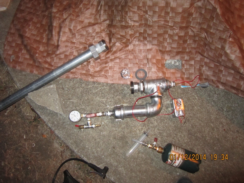

I took this hybrid up to 6x today and finally shot something out of it! Turns out that launching a projectile (a pair of socks) dampens the noise a lot, I'm much less worried about police crashing my pew pew party now.

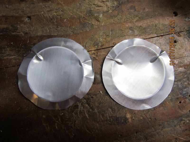

I do have a problem though. I can't get an aluminum can burst disc to work for the life of me. I used them all the time with my old hybrid (1/2" union) but for some reason in this cannon the burst disc edges crimp a little at around 30 psi and leak the mix out. I don't think it's a matter of having the discs perfectly centered but that's all I can think of. I'd like to use cans as discs since they can take way more pressure than aluminum foil layers and I'd like to have burst discs that can take 300+ psi...

How is the fit when inserting the disk in the union? I think that if the diameter is too tight it makes them crimp more. On the other hand soda cans just crimp easier than foil. Also soda cans are slicker and creep more under pressure. Can you tell if the foil kinks due to creeping (slipping) or immediately upon tightening the union. If it is creeping, tightening the union tighter may help. I found that really tightening helped, but it is a hassle to carry big wrenches or big channel lock pliers.
Another option is to use craft foil sold for tooling (embossing) designs in. Craft stores like AC Moore or Michaels stock it. It is much heavier than kitchen foil. I think it is a bit thicker than soda cans but softer and less slick. It comes in sheets and rolls. It is similar to disposable roasting pan foil.

The aluminum can burst discs generally hold pressure until I get to around 30 psi, then the leaks form. I've tried sandwiching a soda can disc in between foil discs but that didn't work either. I guess I'll just use foil until I find a better method, it's not the end of the world.

This has been my experience, making them slightly undersize and tightening properly should solve the problem. Is there a rubber gasket of some form involved in the holding of the burst disk?PeteS wrote:I think that if the diameter is too tight it makes them crimp more
