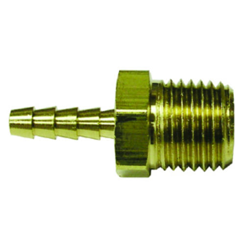

Alright, instead of a Schrader valve (can't find one) what about using a brass fitting like this
I thought about using it in place of the Schrader valve, would this work? I also thought about using a spark plug but I heard a lot about them acting up so I wasn't sure
Whatever the mind can conceive and believe, it can achieve
It should work, although make sure the barb itself is wide enough to fit the wire though with room for some epoxy as well. If the wire isn't well insulated well, the spark won't jump where you want it to.
