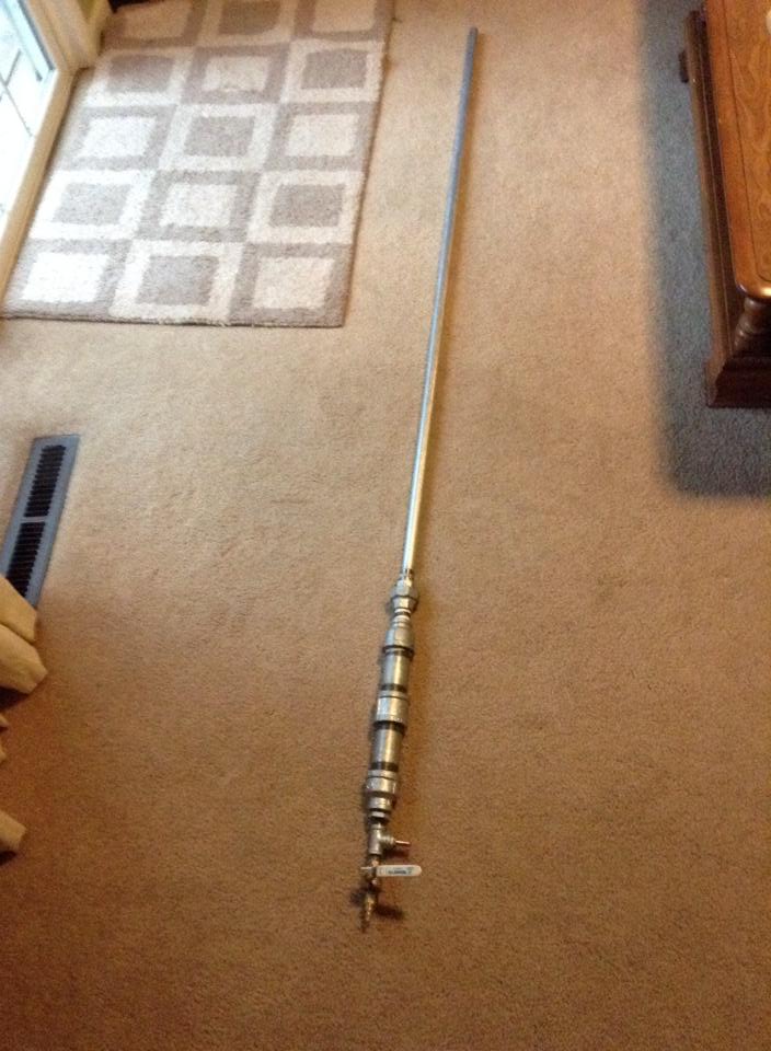

(Skip to next paragraph to get to the details) As the title indicates this is my first step into hybrid cannons, and it took a while to actually get just right, but I love this thing so far (even though I only shot one shot). I got the bulk of the design from using HGDT, but I also took a look at similar cannons made by wyz2285, MrCrowley, and airpress to get a general idea of what I wanted to make. Another thanks to noname, D_Hall, DYI, SpudBlaster15, and MrCrowley for answering all of my stupid questions and helping me out. Any how, I've only dry fired this thing once at 3x mix (I attempted a 2x mix before but my fuel didn't seem to mix well in the chamber) and never having fired a hybrid I had no idea what to expect, yet even loaded down under blankets and pillows it still made an earsplitting bang :D (hearing protection is the next investment)
The barrel is a piece of 3/4'' x 5' EMT pipe but I haven't gotten to connect it to the gun yet, I was going to epoxy it into a 3/4'' coupling and then thread that onto the gun, but the store ran out of couplings and ever since I've been wondering if that'll actually hold up.

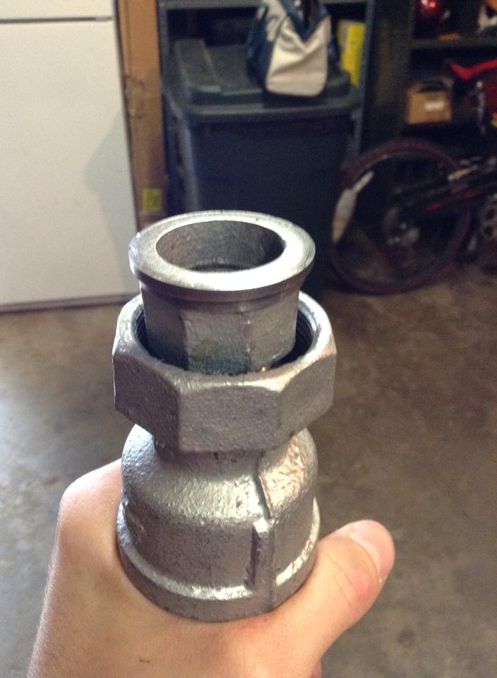

I'm not sure what else to say about it, it only cost about 30$ (45$ with the stun gun and syringe), and I think it turned out quite well so far. I'm not yet sure if I want to make a stand for it with some sort of recoil reducer or just try and fire it handheld. I modified the union using a dremel, to grind it down, a file to even it out, and a sander to smooth it (it took a good 1 and a half hours) but I think it turned out well :)

Sorry for the crappy iPod pictures

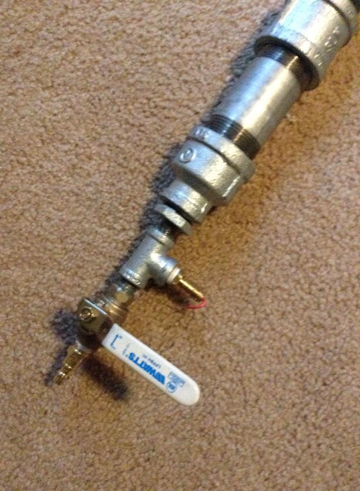

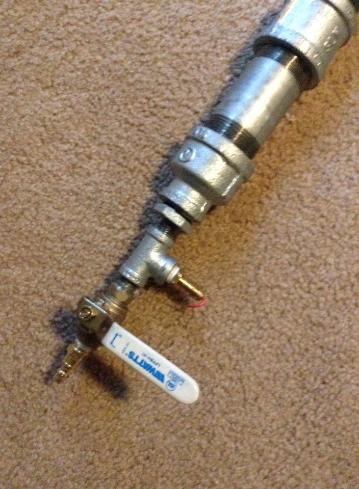

Back of the gun, I just used a regular ball valve; and a hose barb and wire to make the sparkplug

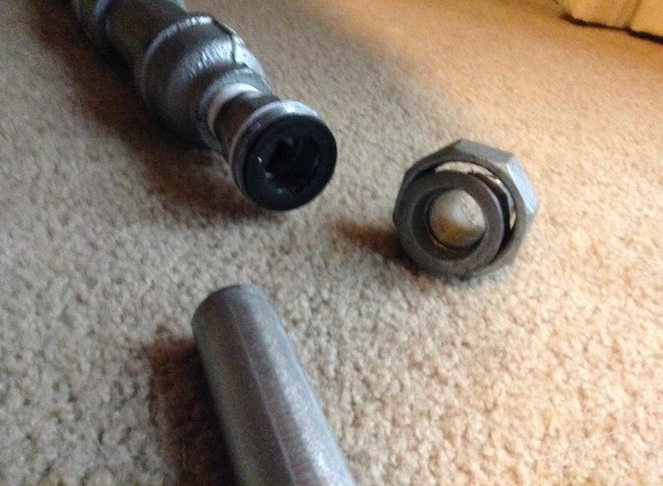

Union setup: I cut up a thick rubber washer for the gasket

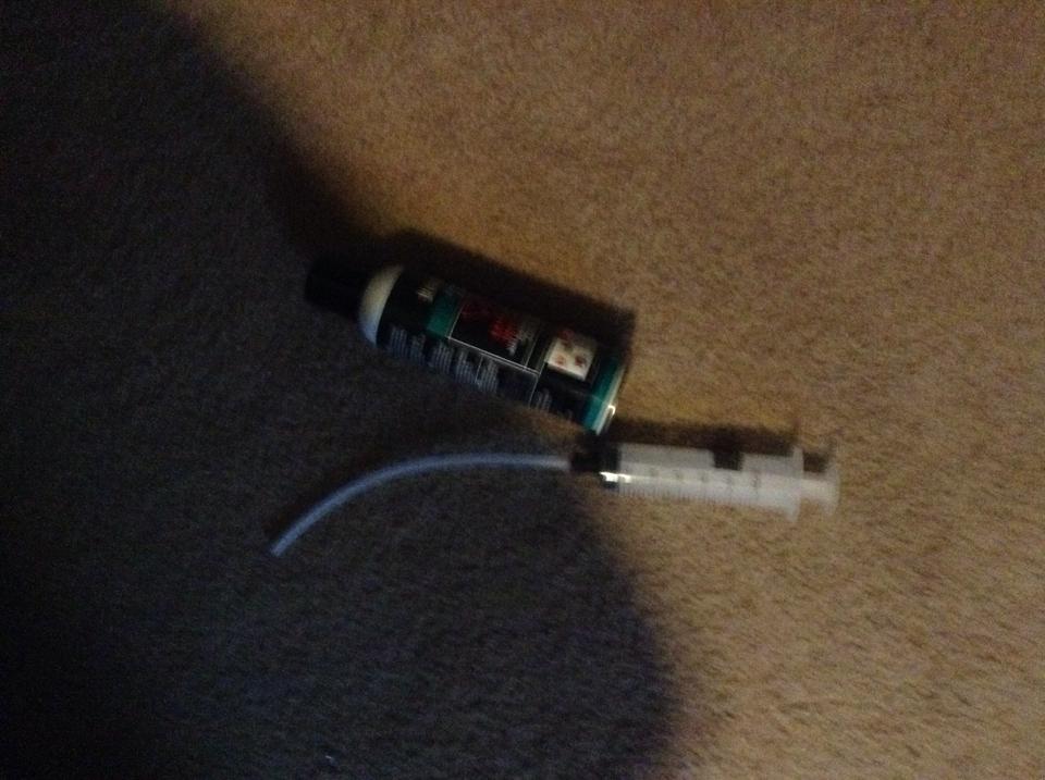

Fueling system
Fueling system

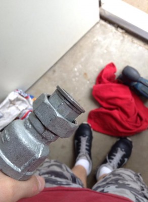

The union (It's direction is reversed)
The union again
The union again

Good to see you got this working, especially considering the awkward ignition placement. I've used regular 600 WOG ball valves on hybrids up to 10X air/propane with no major problems, so you should be fine here.

At first I was pretty worried that the spark plug would be the gun's downfall and had ideas of lengthening the wire so that it could extend into the main chamber, then trying to glue it down at a certain point, but it would have made it quite hard to actually modify the spark gap or replace the thing all together.
As far as the ball valve goes, I believe it should hold well enough, I also got the smallest one they had to try and reduce the amount of force exerted on it (am I wrong to believe that this would actually help btw?).

Thanks! I'm pretty sure at first it was that the fueling, I have yet to completely seal the threads to the union, and after I had tightened that up it was just an issue of the stun gun being crappy. I want to try and get a BBQ igniter, since they don't take batteries (the stun gun has an internal battery that only lasts a few bursts before needing up to 5 hours of charging :( )
And it all that fails then I might switch the places of the spark plug and ball valve, and if THAT doesn't work then I'll try and make some sort of extension onto the spark plug so the wires extend into the chamber itself.

Update: It was giving me trouble so I extended the spark plug so it now reaches to the middle of the chamber, although I don't believe it will last, I need to get it all epoxied yet. But so far it works wonders at 1x mix (I haven't found the volume of the dead space of my pump so I can't very well shoot at higher mixes )

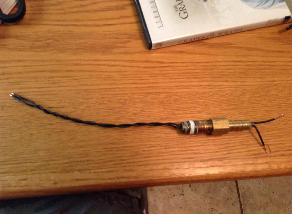

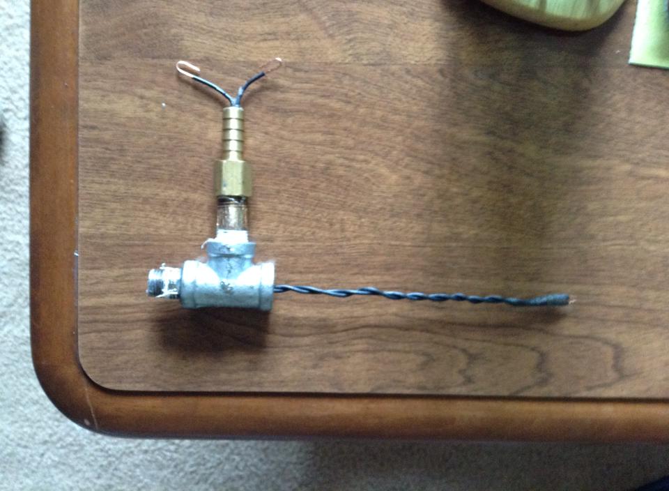

New sparkplug
New sparkplug
Spark plug setup, the leads are epoxied at about 1mm apart and are set to extend just about in the center of the chamber. The wires are straightened as to not allow them to make contact with the conductive body.
