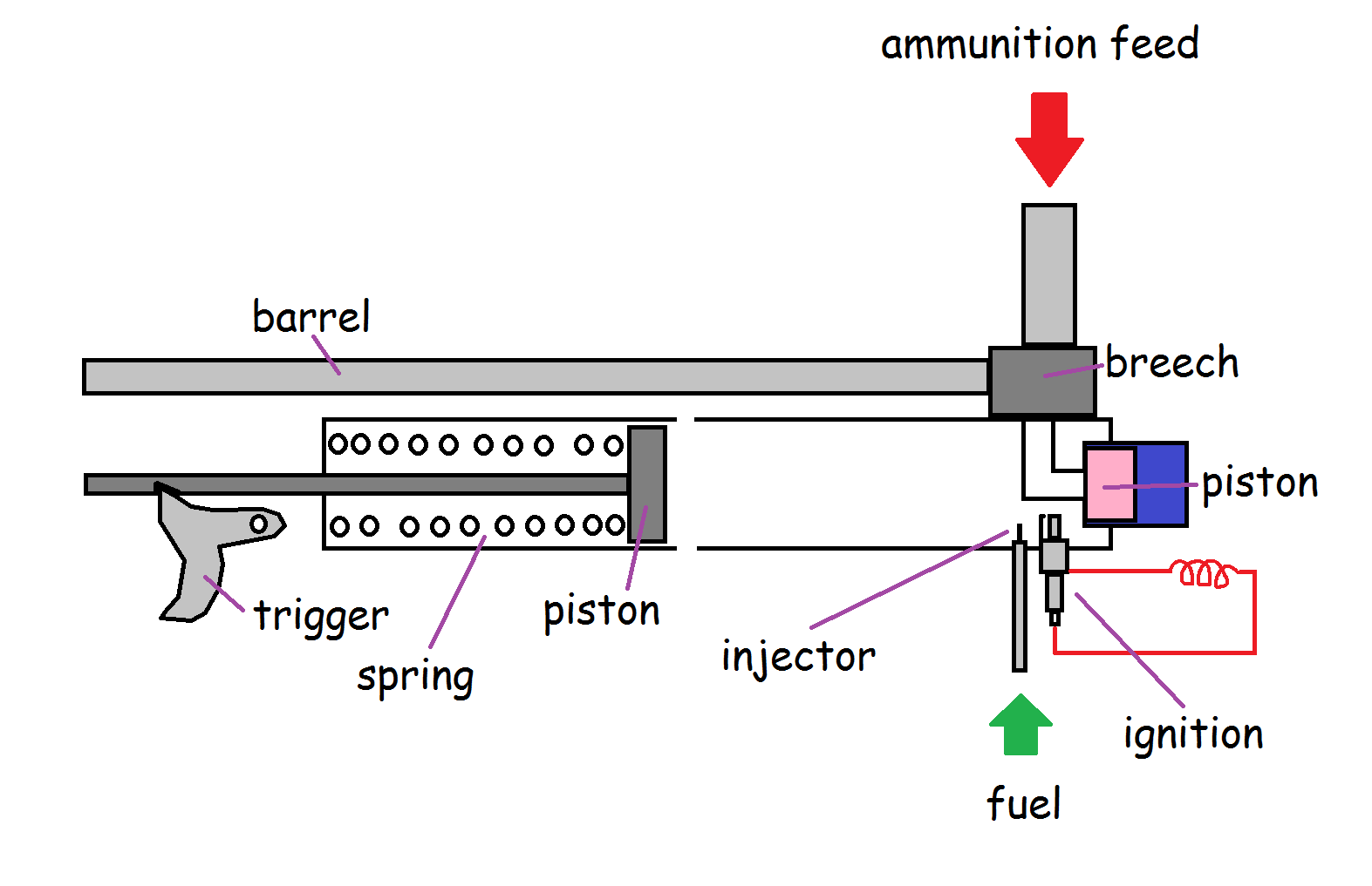

Hello everyone!
I have started on a automatic piston hybrid cannon design that I have been mauling over for sometime now.
Some of my design criteria:
-60 rounds per minute
-3" bore
-Hybrid (of course)
-High mixes (200+)
-Turret mounted
So further more, here is the cannon that will, I hope, come alive some day.
This thing will be a brute with a barrel at a 3" bore and a length of 20'.
Barrel will be made out of aluminum, construction unknown at this point but I have ideas on how to make it.
Working on back from the business end of cannon is the action.
The action consists of the action housing, bolt and bolt actuator. The action only loads a round into the chamber.
As we get farther away from the barrel is the manifold system. It serves as a means to direct to the flow of gases from the combustion chamber to the action. Since I would like the cannon to turret mounted the manifold system has to be flexible yet rigid to withstand the pressures of high mixes and to allow the movement of the action and barrel due to recoil.
To achieve my 60 round per minute firing rate, one combustion chamber would slow me down due to the amount of propellant and air needed to get to high mixes consistently. Therefore I using four combustion chambers which should allow me about 3 seconds to refill one chamber in a cycle.
Now the combustion chamber design that I have chosen is 6" diameter and 6' long. Attached to the combustion chamber is the valve, which is a self-venting auto-sealing piston valve design. I choose to go with auto-sealing design to allow the chamber to be closed before the next chamber is to be opened.
I bet all of you are wondering what the heck I am planing to shoot out of the thing. The answer is simple, an APFSDS.
The round is 5lbs solid steel 2' long kinetic energy projectile. Btw this is the coolest part I have model yet besides part of the manifold system.
I plan on using hydrogen as the propellant made on board by a massive hho dry cell generator.
Now for some theoretical figures given by HGDT with MAPP gas which I expect to be higher with hydrogen.
Things I need to work on/finish: (NOTE-At the time of writing this all models are rough ideas)
-loading system
-metering system
-turret mounts and the turret it self
-refine all the models (add o-rings, make it more eye appeasing, etc...)
-different projectiles (optional)
This cannon is still WIP and will be for many years.
I will appreciate all feedback to refine my design before I build it and I will be glad to explain anything about the design that is unclear. I would also enjoy if everyone helped me with a name for this cannon.
P.S. I already have an idea for it's little brother.
We is not Psychos me promises
