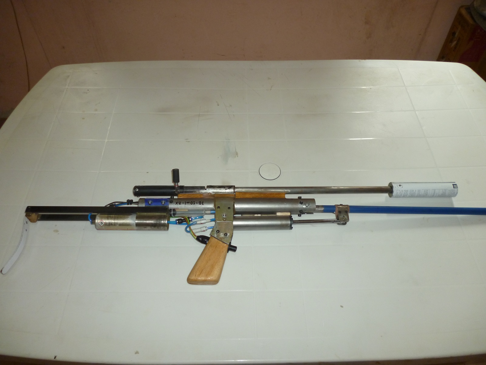

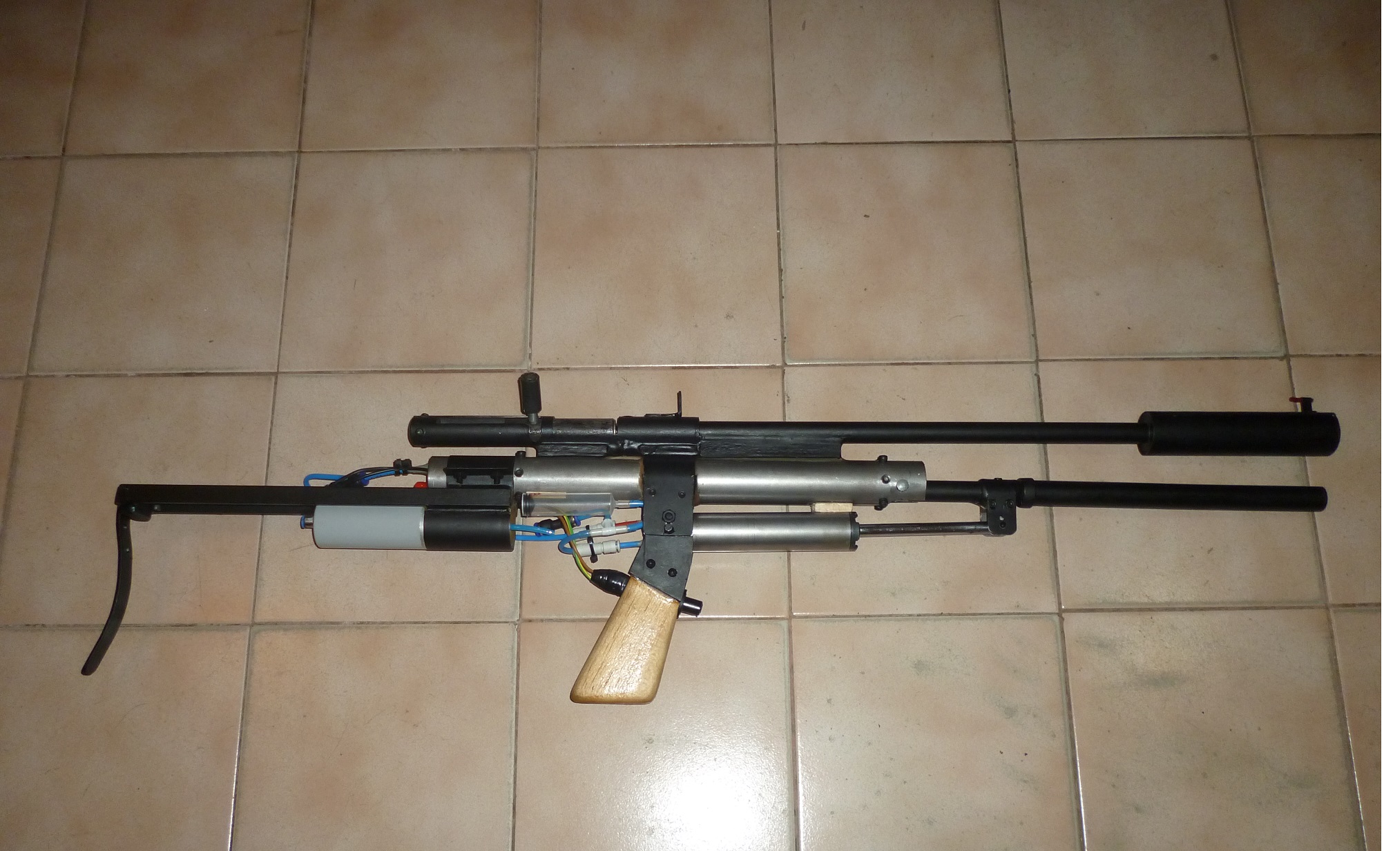

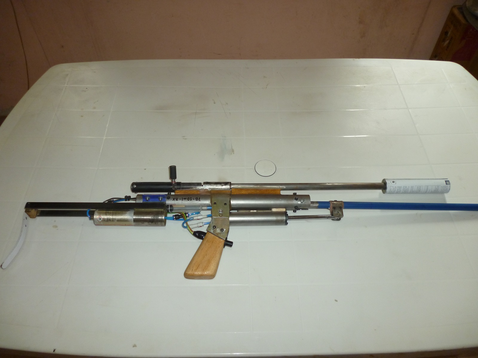

This is my new project, almost finished. I need to paint it. I have not used
wood, just a little bit, in the grip where the piezoelectric goes because I thought it was nice that everything is in sight.
It is the simplest, easiest and fastest gas dosing system to build,
and it does not fail. :D
The weapon is an autonomous hybrid that shoots steel balls of 1/4 ", to 8X.

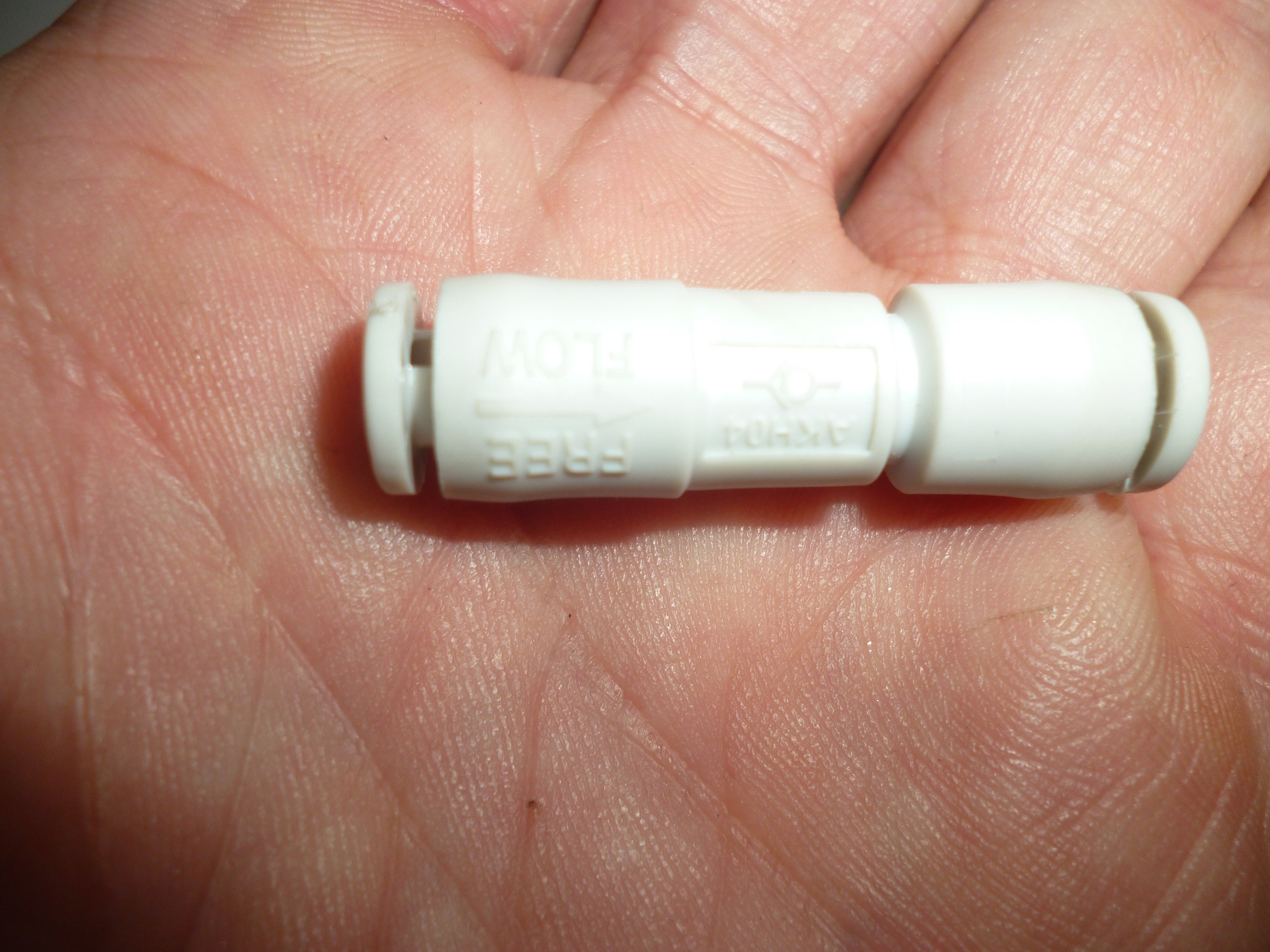

The air pump has been optimized to achieve that pressure, without much force,
with 7 pumps. The tube of the air pump has a diameter of 27 mm. The two valves
of the air pump are commercial, and support, according to the manufacturer, up to 10 bar.
The two valves of the combustion chamber are manufactured by me, and
They work very well for combustion pressures.
The firing pipe is smooth bore, built by me. It has a thin steel tube outside,
with polyester resin inside, to give the caliber of 6.35 mm.
It is light, only 1.9 kg.
I have incorporated a very effective silencer, because the noise no longer bothers me.
It is built with an aluminum tube, i have glass wool inside,
to decrease the acoustic energy of the gases.

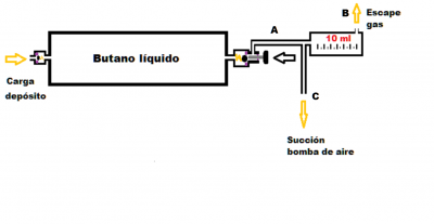

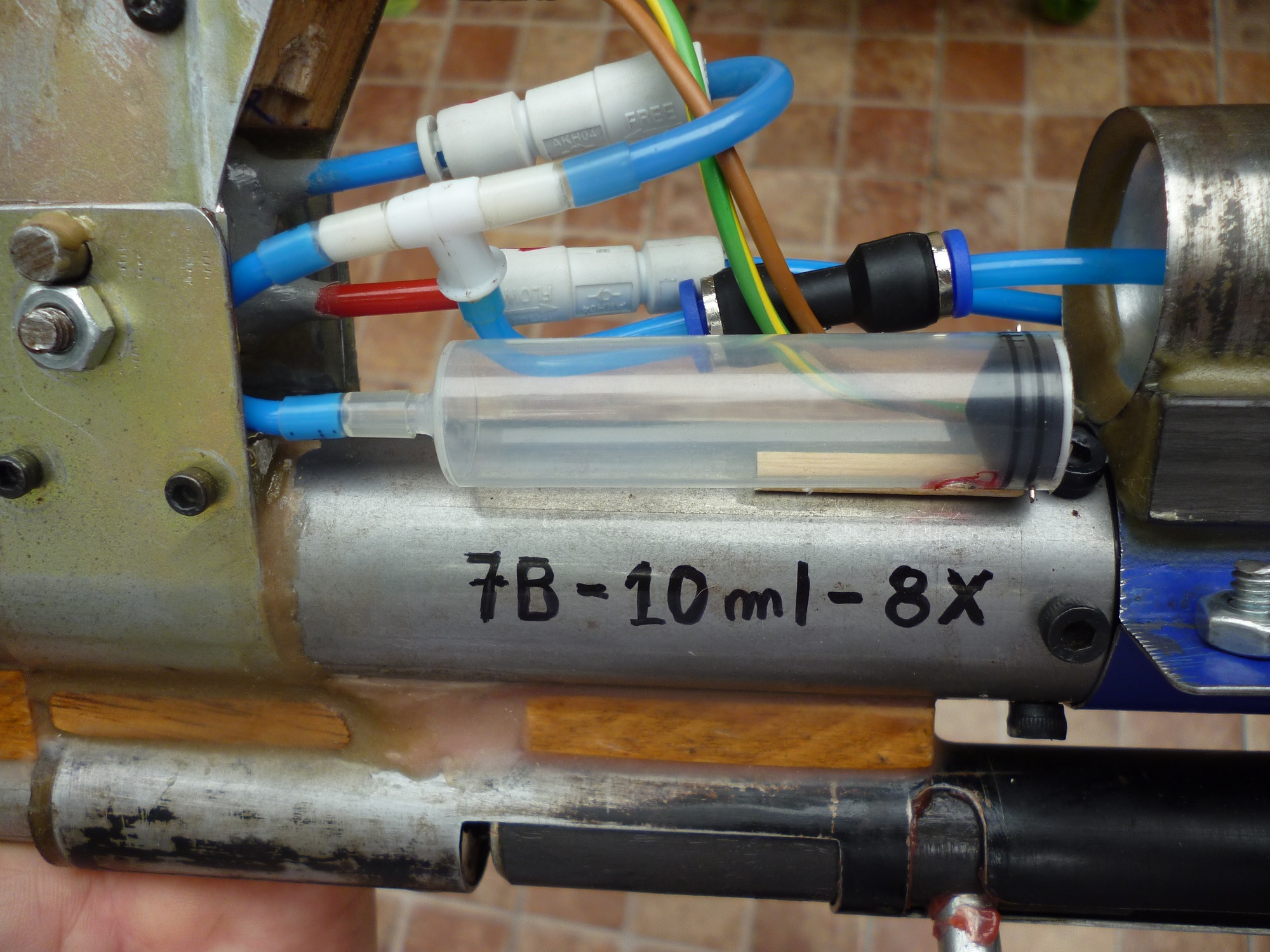

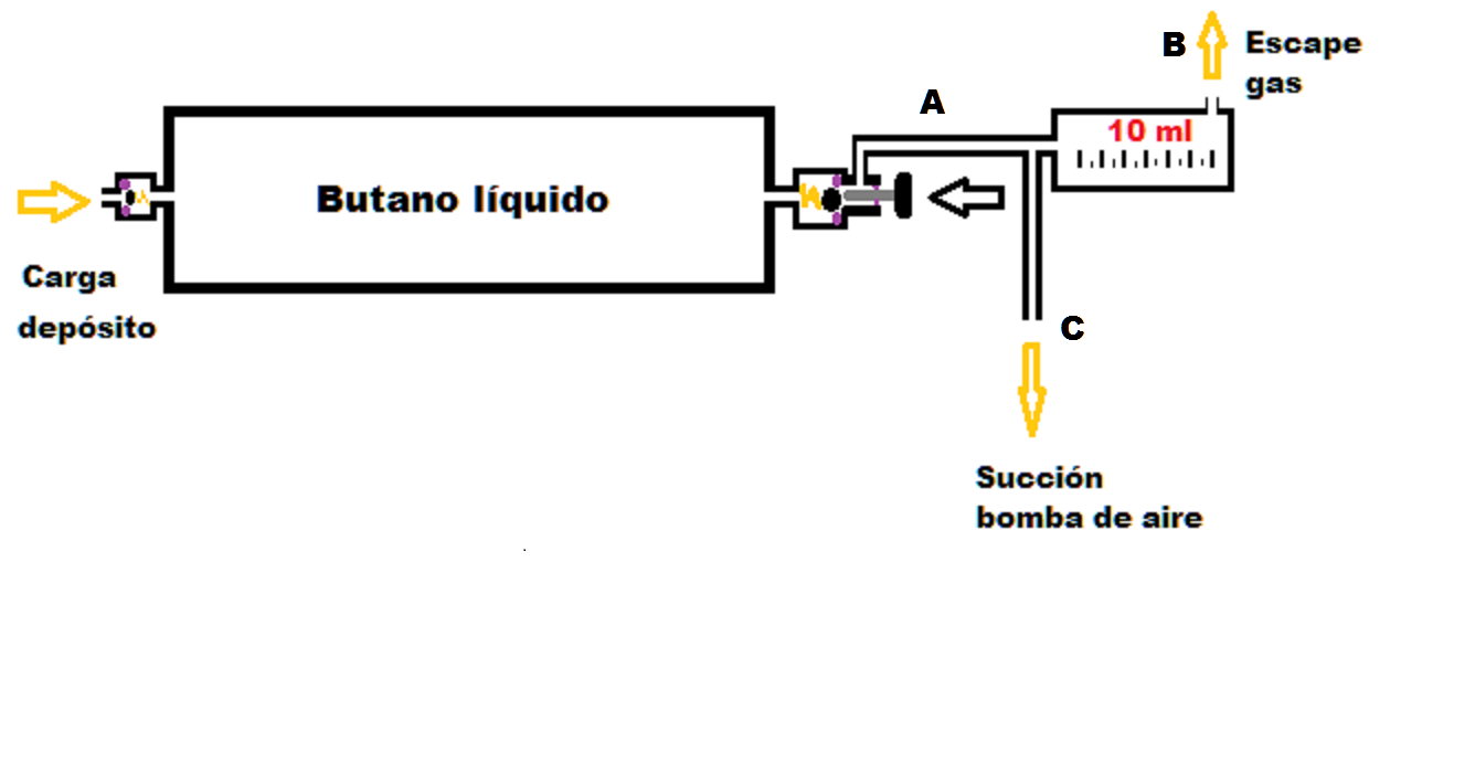

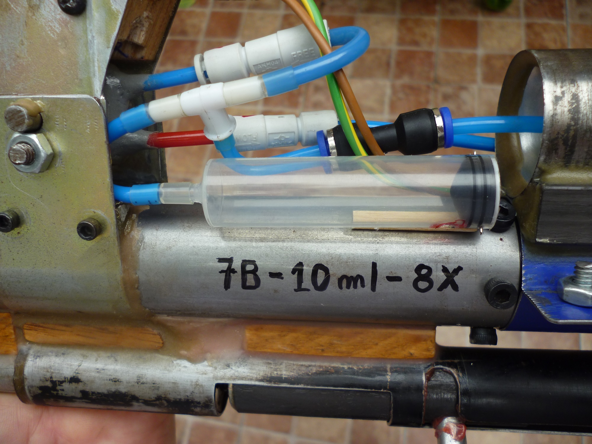

The fuel gas tank is a simple and common small aerosol, and I use the valve
that comes incorporated from the factory, to inject gas into the dispenser.

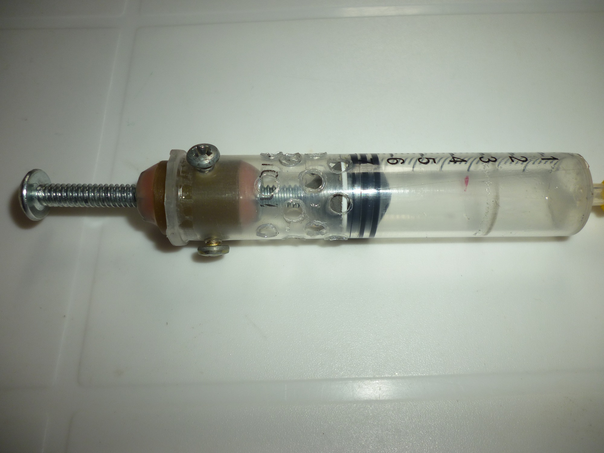

The gas dispenser is only a plastic tube of 10 cm3 capacity, which is the
that burns this weapon. It has no piston, and is not subjected to any pressure. The gas when entering
by "A", it dislodges the air by "B", and the gas that remains inside, is then sucked
by the suction valve of the air pump, "C", and introduced into the combustion chamber.
Simple and without failures, for this type of volumetric meter for small arms.

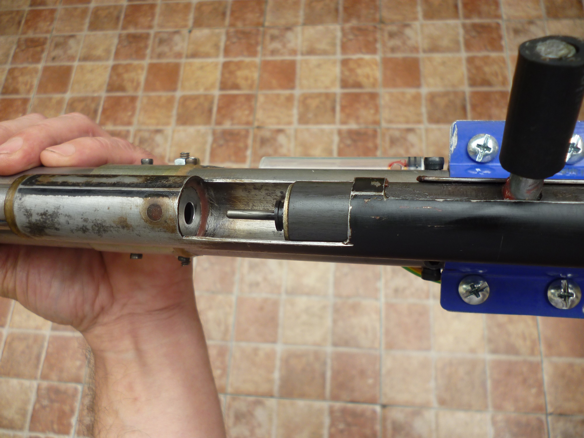

The combustion chamber has a single hard spring, which is responsible for retaining the pressure
of mixing, and leaving the camera with zero volume after shooting, to clean it completely.
I'm using 8X, but the system can hold mix up to 12X without opening the hole
gas exhauster. The problem is that it is not safe to reach so much, because the thickness of the steel tube
recycled from a shock absorber that I am using, only 0.8 mm. I have steel tubes with burnished
inside, but this one in the Mr. of the winch, delayed there.

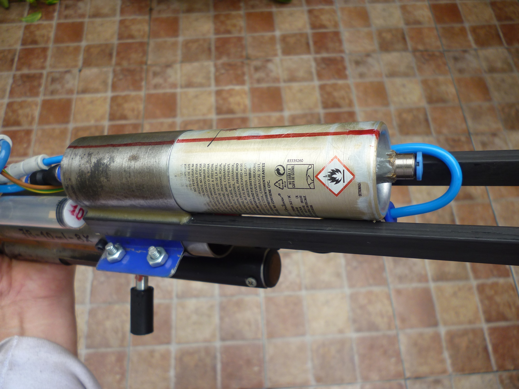

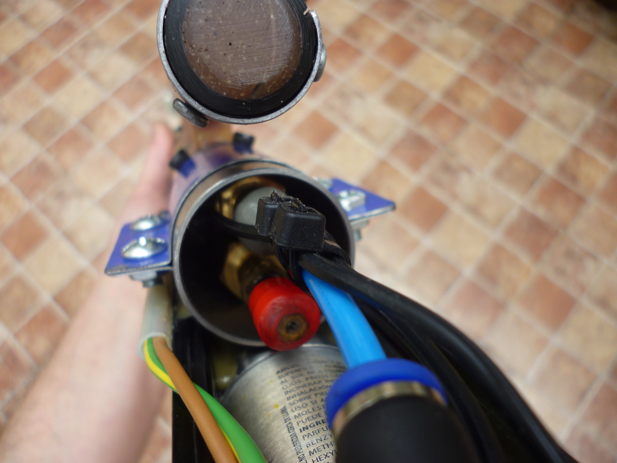

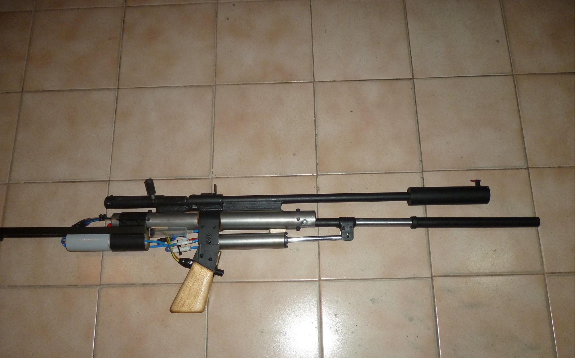

The red color command seen in the fifth photo is the valve to depressurise the combustion chamber after the shot. Frequently there is some burnt gas inside and it is necessary to press to completely clean the combustion chamber of burnt gases.
When I make the shooting test video, I'll cast it here. This is a totally homemade weapon,
I mean manufactured with few common things, and without any lathe, or welding. I have already fired some
80 times, and everything is still in place. We'll see how it works with more shots. :)

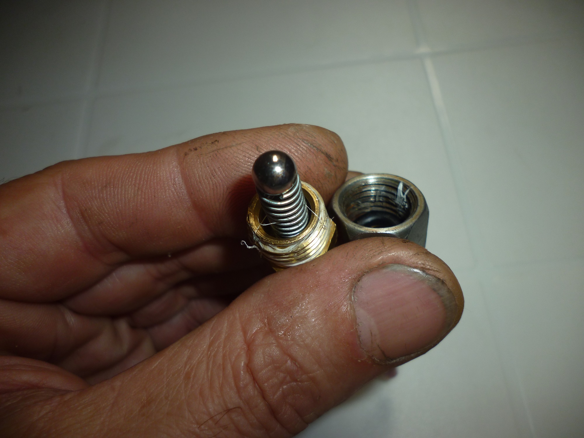

Válvula retención bomba de aire
Dosificador gas regulable
Dosificador de combustible

I have thought about cutting the lever because it is uncomfortable to be longer than the firing barrel. I tried and needed a lot more strength, and it would be difficult to pump when I tried higher pressure. The solution was to incorporate a lever that extends and retracts. The painting has improved it a lot, always within its classic appearance of homemade invention. This is how it looks in the present: :D

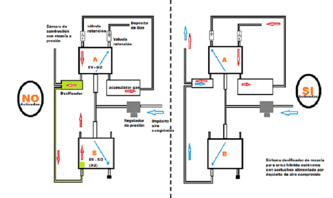

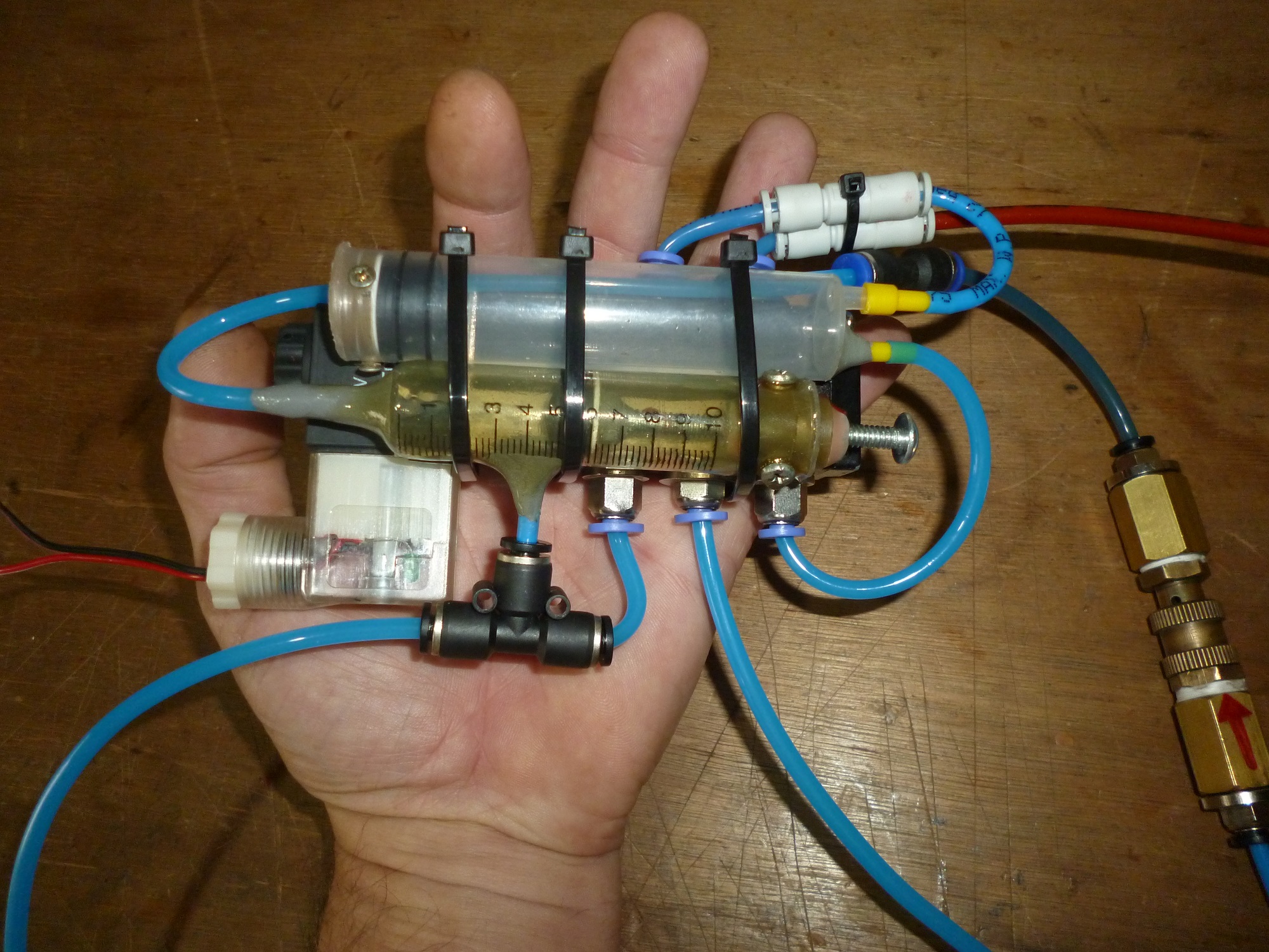

Automatic mixing dosing system for hybrid weapon
This system is the one that I am considering using to feed my
small hybrids without air pump, with compressed air tank. It works very well already,
I'm just waiting for it to arrive, a solenoid valve that I do not have. It's quite compact.
Use a 5/2 solenoid valve 12 vol and a 3/2 solenoid valve 12 vol.
I have used two 5/2 because they are less expensive and easy to get by these sides.
I think the diagram explains how it works. If someone who is interested,
Have any questions, hageme know to clarify.
The two valves are activated and deactivated at the same time. It has an electrical contact, (push),
in the bolt handle where the ammunition goes. When the hybrid cartridge is inserted,
and you move the lock to close it, the two valves are activated for 1.5 seconds, which
This is what it takes to introduce the pressure mixture into the combustion chamber. This weather
it is controlled and regulated, with electrolytic capacitors that provide energy
to solenoid for this time, once the bolt button has been disconnected.
Just load the cartridge, (which includes the rupture disk and ammunition), and fire.
The green hose is what you have to add to the amount of butane gas
which delivers the dispenser, which is adjustable, to adjust the mixture in the installation of the weapon.
I will update in the future.
That's how it's going to be ... I have to replace the three-way valve that is visible and to the right of the photo, by the solenoid valve.

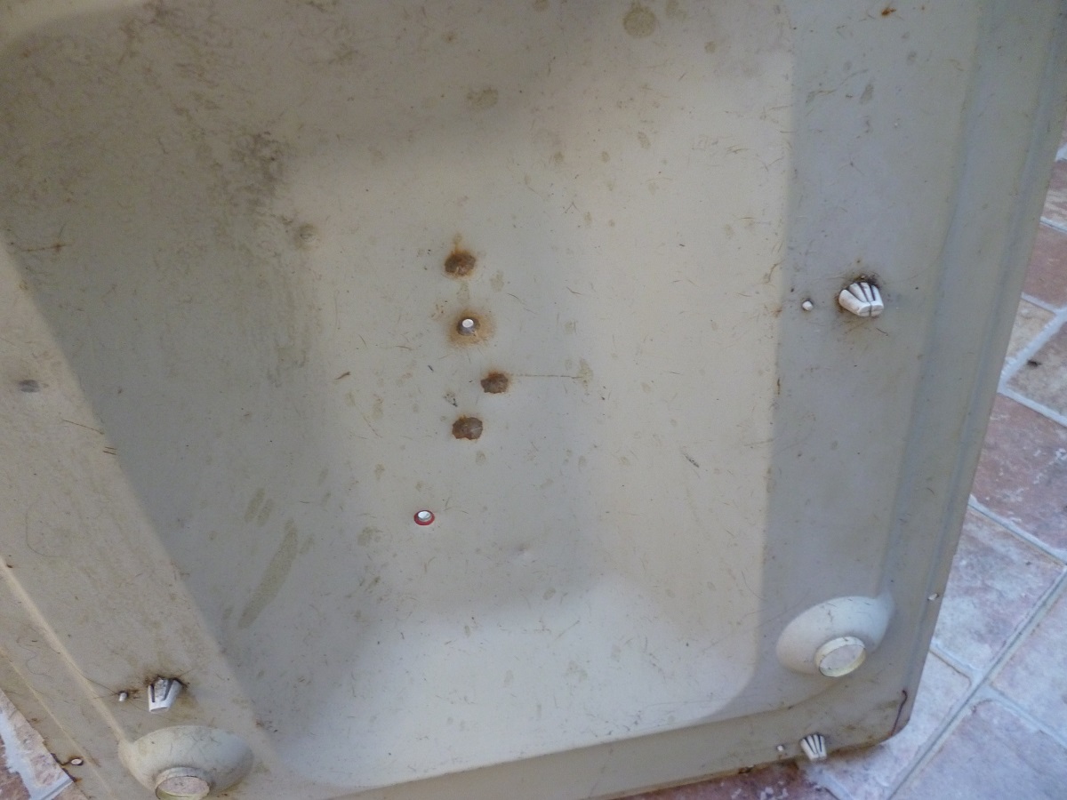

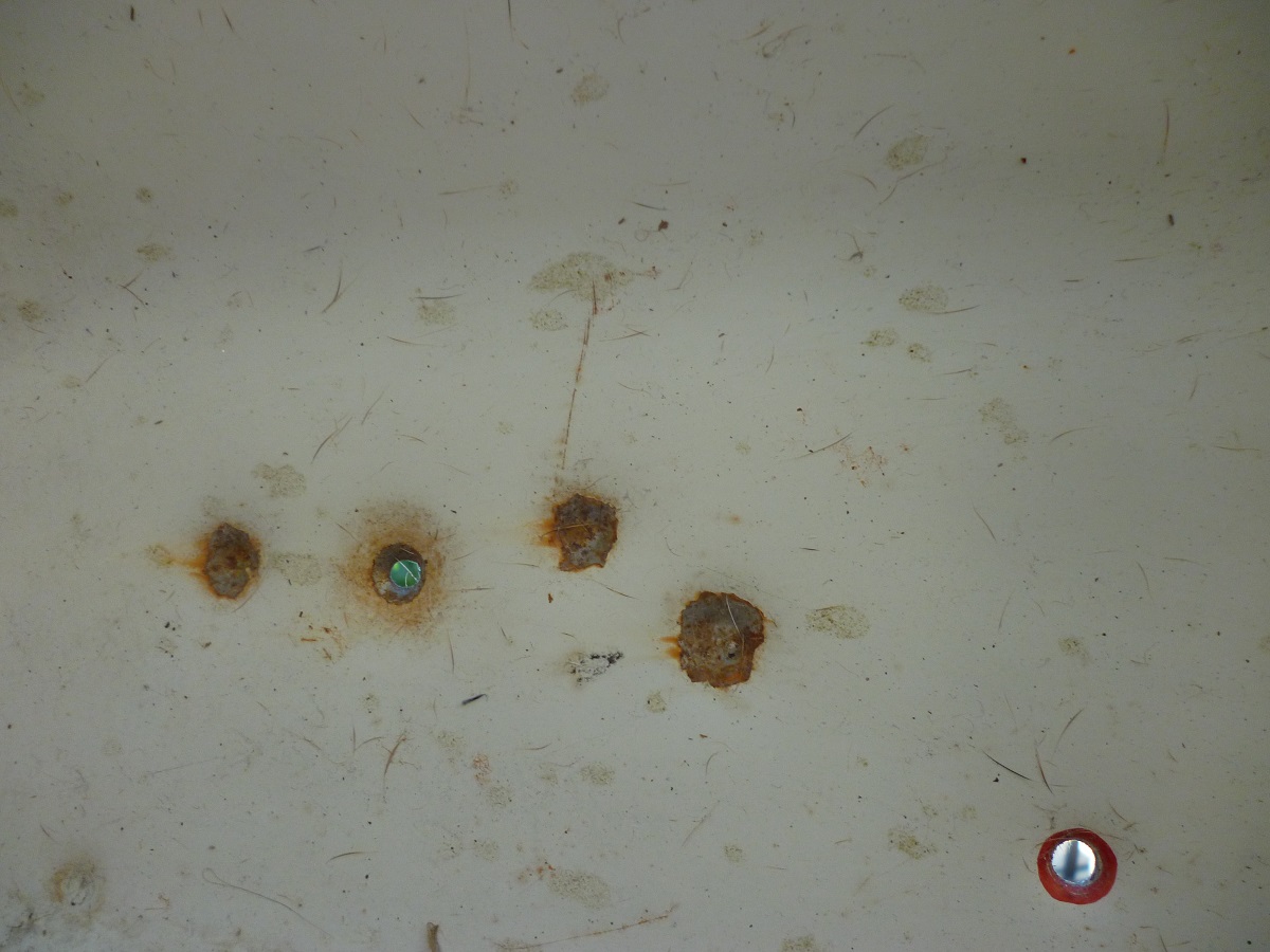

Update of today's prototype.
I have included a hold with an o`ring. The strength has increased considerably. He passed a 0.8 mm steel plate cleanly with 7X, and the noise has been kept controlled with the muffler I have installed. I have fired without the moderator, but it is very unbearable for my ears. It was just to know.
In the photos, the red mark is mine, 6.35 mm, the other one is a 5.5 mm pcp.

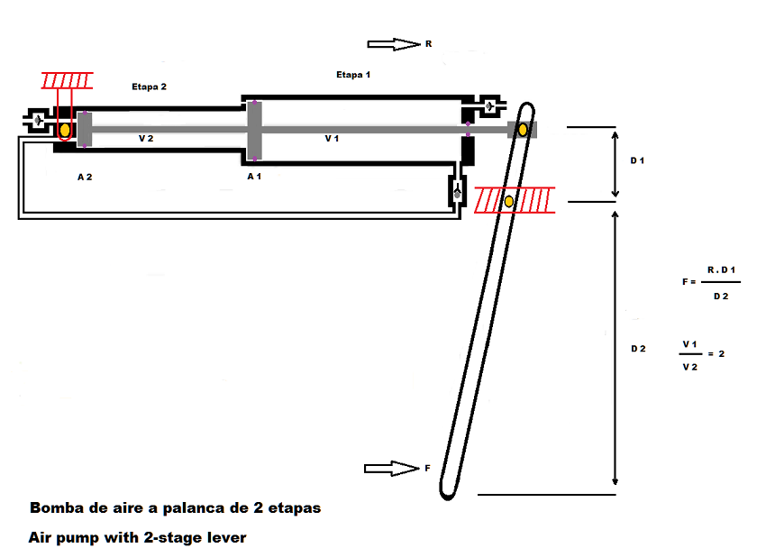

This is the new two-stage air pump with power lever, which I'm building for my next stand-alone hybrid prototype 4.
It has a volume ratio of 2: 1. It allows me to decrease to 3 or 4 pumps to obtain a pressure of about 9 or 10 bar, without it being too hard to handle. I am building it in the present and I hope it works correctly.
The priority is that the pump is as compact as possible, and that I deliver about 150 - 200 ml of air at about 9 bar, and that the pumps are executed with the least possible force and the least amount possible. Actually with the HA 3 after shooting 20 or 30 times, my arm is left hurting ... :| This is, I hope it is really like that, the solution for all this. :)
