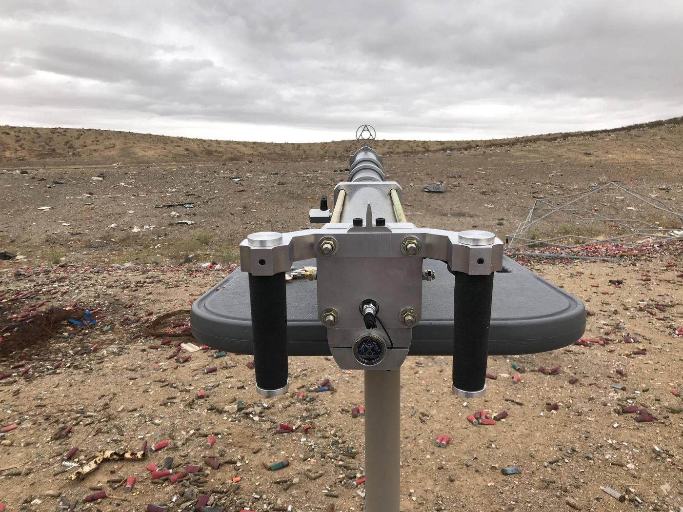

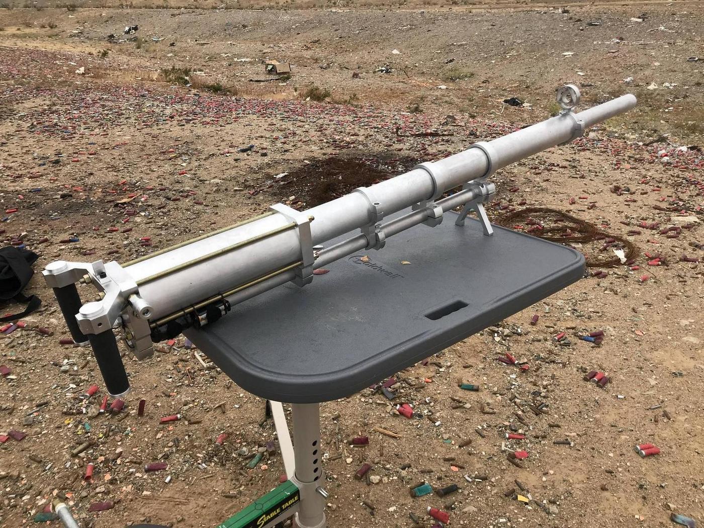

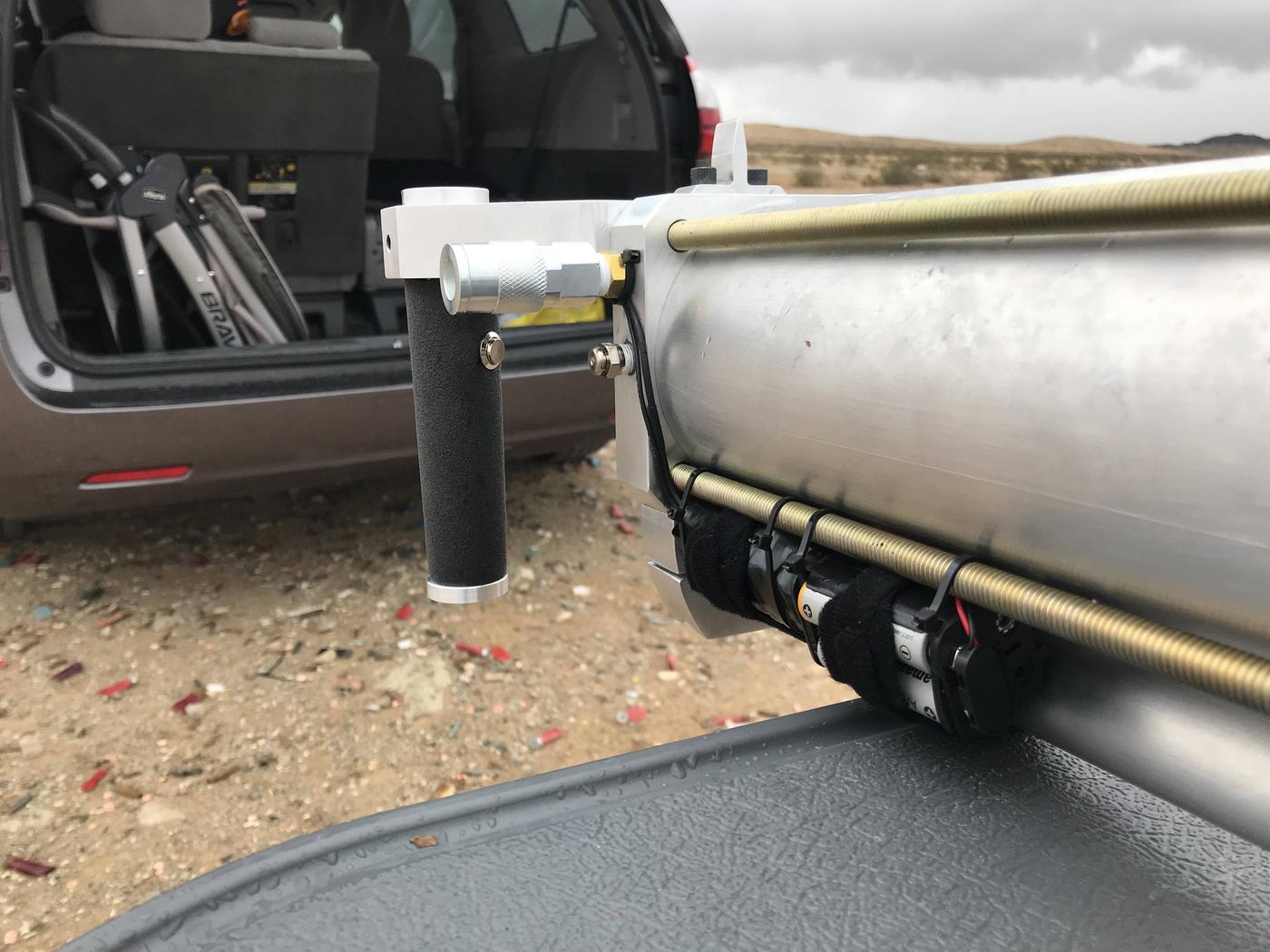

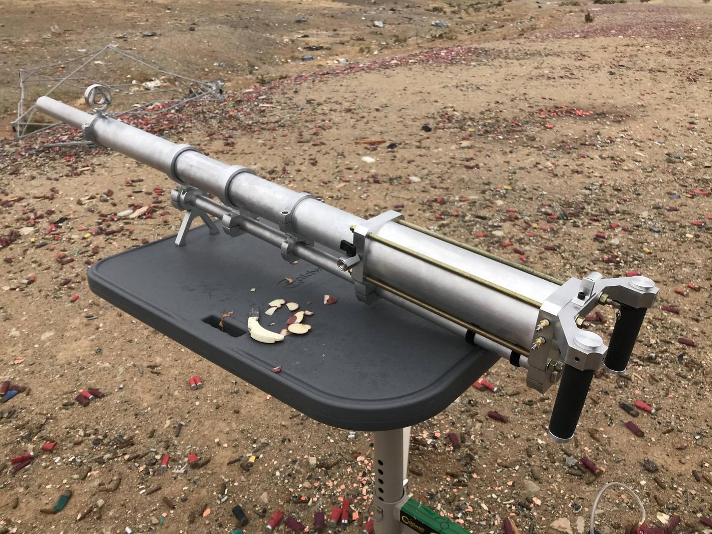

This is the SC3650 In-Line Piston Hybrid Cannon. The entire build log from beginning to end is in the link below. I'll just show the cannon here and keep it simple.
http://www.spudfiles.com/hybrid-cannons/topic26921.html
EDIT - June 5th, 2019: Fueling improvements increased performance.
first 2 shots are full 12oz soda cans
3rd shot is a potato
4th shot is a golf ball
Here's the money shot!
