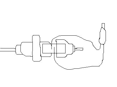

I'm going to make a really frickin small hybrid. Just a 3/4" or 1/2" SCH 80 nipple, a galvanized reducer to 1/8" Schrader, and a 1/2" or 3/4" union with a BB barrel on the other end. Probably just a BBQ igniter for the ignition.

How do you intend to pass the BBQ sparker wires into the chamber? The chamber conducts, so you can't use screws or something like that...
I'm working on a large-scale metal hybrid. For my ignition system, I pass the wires into the chamber through a quarter-inch bushing, with the space around the wires filled with JBweld. I use well-insulated wires connecting to a spark strip. You could build a mini spark strip and do something similar. Just put a T on the back with the schrader on one end and the ignition wires coming in the other.
By the way, with hybrids, smaller spark gaps work better. I'm talking teeny, 1/32" or so. A BBQ sparker might not be the best for this. Consider a camera flash (easy to build).

There is going to be like 3/8" of exposed sch 80 in which I'll put two little screws like on <a href="http://home.comcast.net/~irwinner/potato.html"> this gun.</a>

Exposed sch 80 what? PVC or metal? You can't put screws for an ignition system through metal; the metal chamber will conduct (shorting the circuit) and you won't get a spark. If you're going to have exposed PVC that's taking pressure, then that will be the weak point of the gun...

My mistake, guys. I confused this with another thread and thought he was making the chamber out of metal. My apologies for the confusion.
