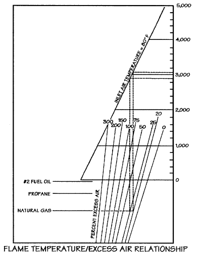

- These next 3 pics are representing a hydrogen / carbon gas as fuel on the left and oxygen / nitrogen as air on the right.
Using -sprays or aerosol propelled liquids that do not evaporate completely and are, for practical purposes, impossible to measure. - common3.gif (4.67 KiB) Viewed 5717 times
- Typically what you see when you use the trial and error method of giving a short blast of propane / MAPP / butane
- common4.gif (4.58 KiB) Viewed 5717 times
- What you want to happen: use up all the oxygen (O2), thus maximizing your combustion.
- common2.gif (4.64 KiB) Viewed 5717 times
- see #4. If you remove excess air from your chamber by regulating your fuel and your oxygen percentages, you will increase your temperature which greatly increases your flame speed.
- combus10.gif (16.61 KiB) Viewed 5717 times

Idea for heating the mix:
Put 1 inch peice of pvc pipe on where your gas inlet is and glue it, so that th inlet is at the bottom of sort of a "cup", then put layers of copper mesh(can be found at most hardware stores) in the cup. As the gun fires, the copper will store the wasted heat energy and warm the propane as it enters.
You could also line the chamber with copper to heat up the O2 you put in.
someone should try this to see if it helps any.
