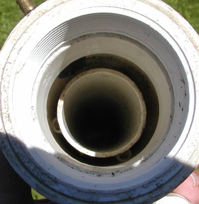

As promised, here is the support for the Golfball Bazooka. This is a coaxial with a 1.5 inch golf ball barrel inside a 2.5 inch thinwall chamber. The barrel is supported by a couple of sets of poly tubing. The tubing was drilled in the middle crossways and a zip tie was threaded through the holes. The tubes were spread out and zip tied into place. In the photo below you can see the ones nearest the breech. It is sturdy, accurate, and has great flow.
The Mouse musket uses the same thing, but it is spaced further from the breech. The Mouse musket, a short launcher, has just one set of supports about 1/3 the way from the breech. The GB cannon has 3 sets of support along the barrel due to it's length. This gives the GB barrel excellent support.
