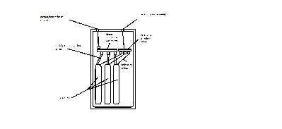

im building a remote battery unit to go in a spare pouch and have a curly wire from vest to gun . im thinking of using a bank of lipo battery's although
simple i am wondering if i could use RC lipo battery's because of there lower price?

No matter what the intended use it's all about volts and amps, do the math and you should be fine

I would suggest using one big battery (or whatever you need) and somehow add it to your weapon. You never know when you'll need to drop the gun or move it in some weird angle/fashion.

If using batteries that can supply very high currents, place a proper size fuse in the battery pack. A shorted out connector with no way to shut it off is no fun when the cord becomes a smoke bomb and then starts to set everything it touches on fire.
Safety first on high current batteries.
