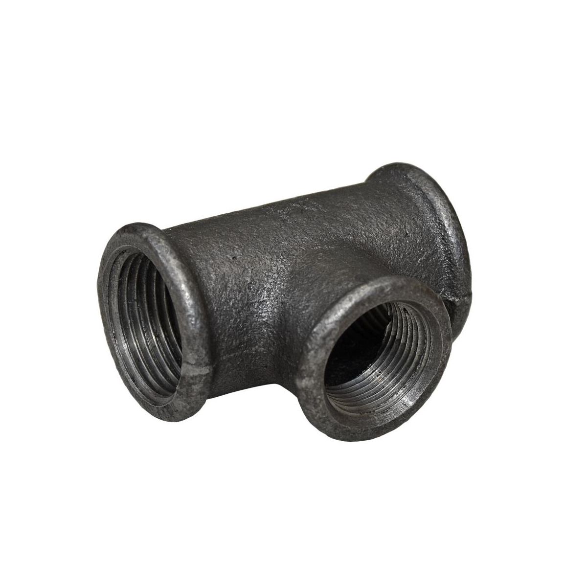

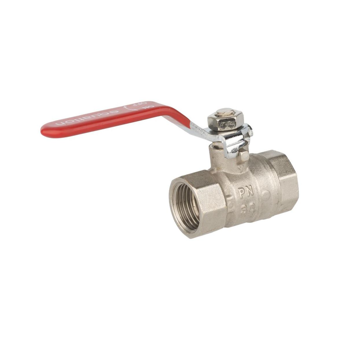

I have another question. Will this steel tee and ball valve hold 200 bar pressure? Steel Tee has pressure rating to 25 bar. Brass ball valve has 30 bar rating.

Q: Will this pipe fitting handle 10 times its rated pressure, in an application close to my head?
A: Have you heard of the Darwin Awards?

So it wont be able to hold that? I found that Joerg Sprave was using ball valve rated to 150 psi and it was able to hold 200 bar.

It might hold. It might not. It's the "not" case that is worrying. If something lets go, things will get ugly very fast. Think "fragmentation grenade". I've seen the results of a small worksite compressor tank (luckily, there was nobody nearby) that failed at 8 bar, it tore the back out of the van.
If you're dealing with stored gases, rather than incompressible fluids, your safety factors need to be significantly higher. In this very thread, you were worrying about the pressure rating on a bottle that's designed for high pressure gas storage, but will happily go ten times higher than the maximum "safe" rating on fittings when high pressure rated fittings and valves exist. They're almost certainly more expensive, and difficult to get "over the counter" - you may need to find a specialist supplie - but you'll be working within the design parameters of the components rather than trusting to blind luck.

You're right. I think i will buy high pressure rated fittings because i dont want risk. I even found that 250+ bar rated tee costs less than this 25 bar rated tee... How about 3000 psi rated aluminum paintball tank Can i take it to 300 bar?
Sat Jul 06, 2019 2:22 pm
I've used that style of ball valve at 55 bar, but that was at my own risk, I wouldn't recommend it.

Regarding the valve question. I took a small brass needle valve to 450psi and it was rated for I think 200 or something like that, and it leaked at 450psi. Even if the valve doesn't explode (which it might) it is still likely to leak at such a high pressure. I don't know if those seals are designed for 10X their suggested pressure. Also, with air pressure that high, can't the thing explode if even a little oil or other contaminants get on the threads? Scary as HELL!

Nevermind i think i will not use ball valve. I just found a pcp one way filling valve for 10$. Something like this
