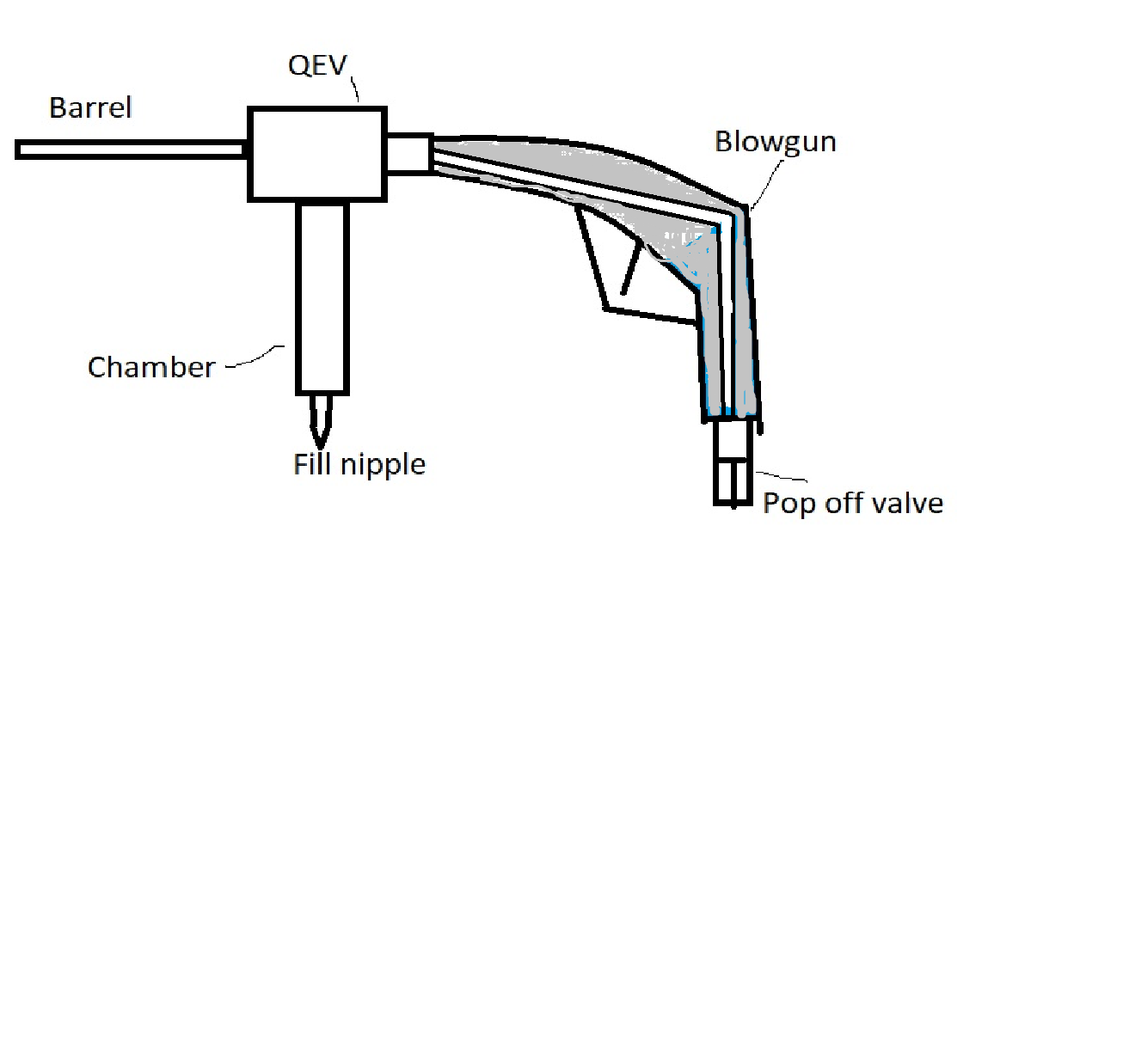

Hi , i was planning to make airsoft full auto gun , with qev and adjustable pop off valve. The problem is when i fill the gun with air pop off dont pilot qev and all air goes thru pop off valve and it sounds like ss-shhhhhh. I think pop off cant pilot qev beacuse the air is still going from blowgun. I mounted on blowgun ball valve for smaller flow. I dont want to fill it from the chamber side so please help me.

Air goes too fast through the gun to pump the wheels. Due to the large flow of pop-off, the valve cannot close. After the gun and in front of the pop-off valve, put a partition with a very small hole, with a diameter of 1-0.5 mm, not more, this will help.
Herwer wrote:I dont want to fill it from the chamber side so please help me.
Why not? It would be much more efficient...
Otherwise you're going to need to balance flow from the air feed that is just enough to put sufficient air to actuate the pop-off, but not too much that the air coming from the feed refills the pilot chamber so fast that the pressure doesn't drop enough to actuate the QEV.

keks2033 wrote:Air goes too fast through the gun to pump the wheels. Due to the large flow of pop-off, the valve cannot close. After the gun and in front of the pop-off valve, put a partition with a very small hole, with a diameter of 1-0.5 mm, not more, this will help.
I dont get it. partition where? can you tell me more
Maybe if I puncture 1mm hole into piston and add spring to qev, this desing will work? i dont want to make chamber filled qev beacuse this is my last qev and i need this for other project. And I'd to make homemade qev that will be using hot glue piston or epoxy putty piston , so i cant make the hole
The issue is the volume indicated, this expansion alone might be sufficient to fire the mechanism because of the pressure drop in the pilot volume.

jackssmirkingrevenge wrote:Image
Sorry , but i am not really good in english , so it wont work for this? or i dont get it?

how about this? he have big pilot volume, he is filling from pilot side and this is working for him with standart pop off. Maybe if i will add more pilot volume and change my adjustable pop off to standart it will work. He said that adjustable pop offs arent working with this desing. http://www.spudfiles.com/pneumatic-cann ... 37-15.html

there is too much extra volume in the gun. Pop of the valve does not have time to lower everything, so that the piston valve would work. Try to fill the whole empty space with cold welding or epoxy glue. For air, make a channel 3-4 mm in diameter, this is enough.
