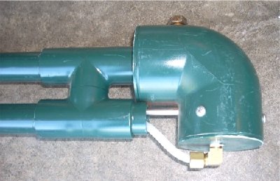

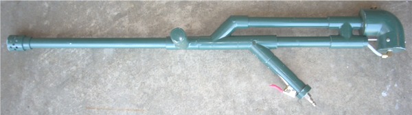

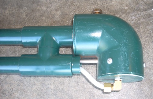

Jackssmirkingrevenge, yep, saw that one. I made a mini-cloud-BBMG using a diaphram valve. The valve isn't after the chamber but the chamber is so small that there is a little less pressure drop.
From here.
As it is, this gun gives a ROF of ~7200 RPM (more than a minigun but it only holds ~100 BBs), muzzle velocity 350 FPS. If the ghetto coupler that connects the quick connect to the valve was bigger then the muzzle velocity would probably be increased significantly.
On the linked page (near the bottom) is a calculation of the effective pressure for my vortex BBMG. ... just 18.6 PSIG from a pump resevoir of 120 PSIG. If I could actually get 120 PSIG in the barrel of the gun the muzzle velocity for steel BBs and a 3' barrel is calculated to be in the vicinity of 800 FPS. A photo of my vortex is attached.
Detail of the chamber end.
Basic vortex, based on Latke's pages with just a few minor changes.
