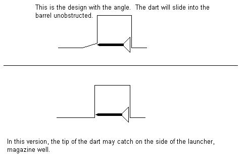

I drew a quick diagram to better explain how they may catch.
Also, the ROF from a vortex or strafer may be higher than the feeding obtained by gravity. It would work with a single shot or shotgun effect, but it would lead to misfires in the full auto version.

Ah I see what you're talking about, that would cause problems.
