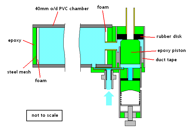

As part of the ongoing saga that is my quest for full auto, this design hasn't died yet, but is currently being modified as follows:
- autopistondiagram2.GIF (10.53 KiB) Viewed 3798 times

so its basically a BtB style pop-off stuck onto a barrel sealer that fills from the chamber. as long as you get the construction right it will work and i hope it does, i'm starting to get bored with all your auto-piston topics
hey look i just noticed this could probably be made with off the shelf parts
maybe you wouldn't have all the construction problems if you did that
He might have built it first but in all fairness we had arrived to the same design independently, and anyway, it's basically how commercial pop-off valves work.BtB style pop-off
You and me bothi hope it does, i'm starting to get bored with all your auto-piston topics
Naturally, but would it be as compact and, more importantly, as cheap?hey look i just noticed this could probably be made with off the shelf parts
Well I am not trying to supply or make an army lol. Its just that some of these airguns here are so complex. The stacked tube airgun I made is already fairly complex and it doesnt even shoot auto. I tried to reproduce trigger parts for it, but I cant seem to get the same things over again. So yeah at these small scale highprecision'' projects it is difficult to produce a simple and good working airgun. So thats why I have this goal in mind. I think its an achievement of making a good working airgun but think about what an achievement it would be if u could reproduce it:)jackssmirkingrevenge wrote:Bigger numbers? Will you be supplying an armyant wrote:I have always tried to make them more simple so it easily can be made into bigger numbers. But yeah impressive stuff here. Plz post a video once u got it all working; I am curious! Anton![]()

True.I had not yet read the full-auto threads, and I built It without telling anybody about this in advance.He might have built it first but in all fairness we had arrived to the same design independently, and anyway, it's basically how commercial pop-off valves work.
It's different to a commercial pop-off however.
THe snapvalve would be one crappy safety pop-off..
Imagine your compressor is overfilling..bbzzzz
BANG!!
And you are left with an empty(!!) reservoir..
Safetyvalves are made to relieve just a small portion of the pressure without the typical BANG of the Snapvalve.

no and no... but it would workNaturally, but would it be as compact and, more importantly, as cheap?
