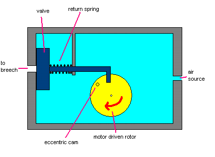

In my early spudding days I had come up with this design that wouldn't really need any fancy circuitry, you could even link up another cam on the same rotor to a rod that would slide a breech sleeve backwards and forwards out of phase with valve opening in order to reload ammunition
Yeah very sweet. The problem is that when u stop the motor right whent the cam is next to the stem then it may not have enough momentum/power to make it open. If it does open if will open less and give u very unconsistent fire.

jackssmirkingrevenge wrote:The problem is that when u stop the motor right whent the cam is next to the stem then it may not have enough momentum/power to make it open. If it does open if will open less and give u very unconsistent fire.
True but if you're firing full auto this will only affect the first shot so not really a problem ;)
