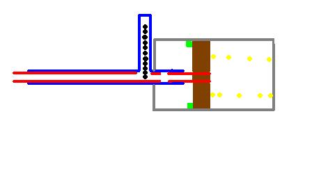

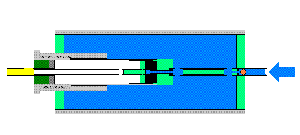

After proposing this idea, I didn't actually follow it up with a prototype, and following some recent discussion I was persuaded to give it a go. I have modified the idea slightly, it should now look something like this, with a separate bolt and valve stem, though the concept remains the same.
The attached diagram shows how I'm actually building it in terms of materials. I used some bits left over from my second blow-forward breech as a starting point. So far I've made the pop-off segment, it works beautifully with different springs at anything from 20-80 psi attached to a track pump, though there is a hint of honking. There's still going to be tweaking involved - namely spring strength and flow into the chamber.
I hope to have it finished by early next week, will keep you posted with my tales of success (or lack thereof :roll: ) as always :D
Last edited by jackssmirkingrevenge on Mon Mar 10, 2008 10:34 pm, edited 1 time in total.

That's awesom JSR it's definently not (bovine excrement :) ) Keep up the good work as I know you will :) . BTW where is the spring behind the bolt?Has anybody thought of this yet?
bolt blows back to load and fire
