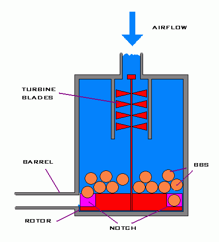

How about some sort of air driven rotor?
