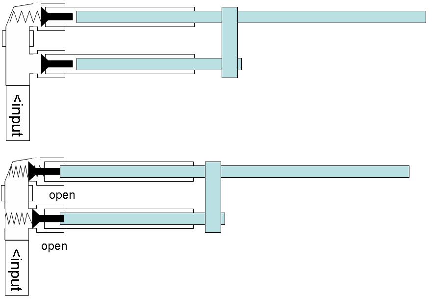

I think I know how it works but I still would like a diagram because I'm not sure and would like to do something similar, you'll have to make one eventually

Wed Mar 26, 2008 10:25 pm
wait I think I got it is this an accurate diagram
piston and bolt blow forward.JPG (36.83 KiB) Viewed 3826 times

iknowmy3tables wrote:wait I think I got it is this an accurate diagram
NIce job! I already made this flash animation of the system yesterday, with loading port and all. I dont get why your bottom valve overlaps the pipe though. In my animation you can see that the bottom tube is close and the top barrel is hollow>plz check the main page for that.
