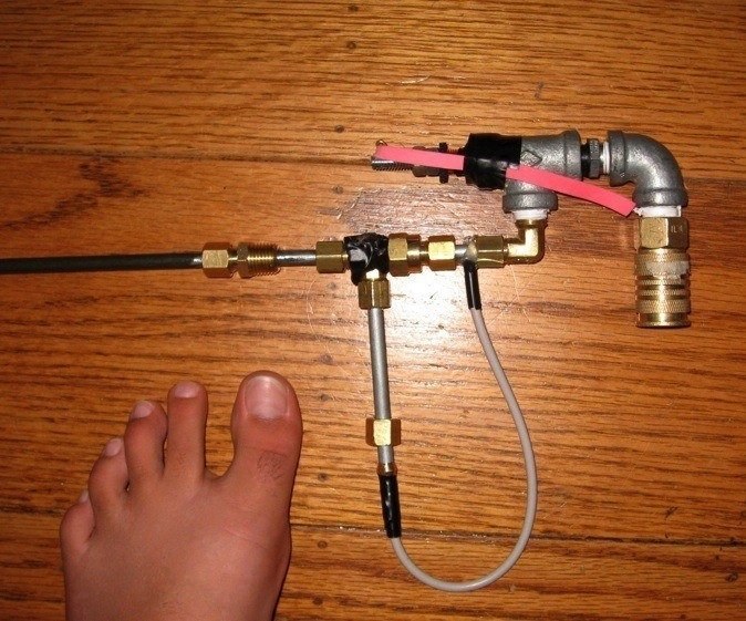

Success! The bb gun now empties all 15 or so rounds very quickly and consistently, I am not sure whether or not the feed completely matches the ram's air output, but it has to be close. Looking at the video I made last night led me to the conclusion the that the bb's were being pushed upwards in the magazine by the pulses of air, so I used a very thin hose (a Lego one
it was what I had..), to route some of the air from the ram output to the top of the magazine, to counter the air coming from below (if that makes any sense).
Here's a pic of the new setup, again, some hot glue and tape is involved, but whatever, it's a prototype. If more than one person wants a vid (for proof, reference, whatever) I will be happy to make one.
Nooooo, not teh feets!
and yes, a vid would be cool
