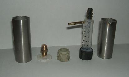

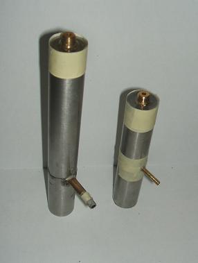

Mon Apr 20, 2009 1:29 pm
Update, v4 is ready and curing. I took the opportunity to document the internals before commiting them to their epoxy casket:
Internals bits before being put together and the epoxy poured in
versions 3 and 4 curing
