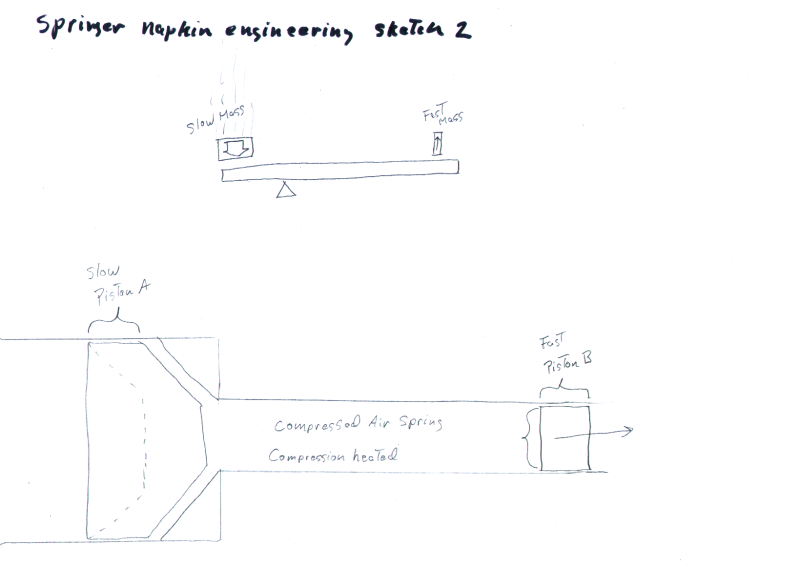

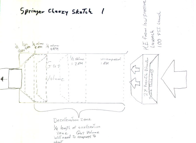

Here are a couple very quick sketches and some theory to chew on.
In this I didn't bother to give dimensions as things can be scaled. For some background in physics, in an elastic (springy) collision of two masses of equal weight, the acceleration of one object takes the velocity of the other mass and leaves it at rest. See Newton's cradle for more info. In an inelastic collision of two equal masses, the center of mass conserves the motion and energy is lost in the collision so the total center if mass still travels at the same speed, but the combined mass travels at the same average momentum which is 1/2 the speed of the first mass. (translation, they stick together and the average speed of fast and stopped is the final speed or 1/2 the initial speed at 1/2 the mass.)
Umm if its twice the mass and half the speed, isn't it the same energy???? Um no. 1/2 the energy was dissipated in the impact and converted to heat. Doubling the velocity increases the energy 4X.. Energy is related to the square of the velocity.
Now on to the sketch. Examine the first sketch. Springer cheezy sketch 1.
Back to the Newton's Cradle toy.. one ball stops and the energy bounces down the row of balls and the last one takes off with all the energy. Too bad we can't stick a lever in there and have a slow ball lever up speed and kick a low mass ball with lots of energy and bring the big one to a stop. Hmm maybe we can.
In the drawing I have a flying piston launched from an air cannon about to slide nicely into a chamber. At the other end of the chamber is a small piston at rest, but the same thickness as the flying piston. Let's see what happens.
1/2 way into the cylinder the air pressure rises from atmospheric to 2 atm. 3/4 the way in the pressure is rising to 4 atm. 7/8ths the way in the pressure is 8 atm and at this point the little piston is getting the idea that it should get serious about picking up some speed and getting outa there. At low pressure it wasn't too excited about getting up much speed so it hasn't moved far yet.
Let's see what our peak pressure may possibly be. If the decelleration zone is 1/4 the length of the air cannon that launched it (assuming a perfect world.. boy am I in for a lesson.) the piston should come to a nice halt at 4X the air cannon pressure because it stopped in 1/4 the time. Ouch sudden stop. Then the air spring would reverse the process and launch the piston back with the same energy except, the little piston moved.. Remember the little piston at the same thickness as the big piston? As the pressure was building it was getting more and more acceleration and it's outta here. Because of the large diameter of the large piston, it has a lot more force on it than is on the little one, but it has 4X the mass. For energy, the compression on the little piston is not like Newton's cradle with a like mass hitting a like mass. It's like a big mass hitting a lever.
See second drawing, Springer napkin engineering sketch 2.
The gas that is compressed provides an elastic collision between two dissimilar masses. The two masses have different areas, so the force from the pressure is different by 4X for a 2:1 diameter difference. This is our gas lever. Both pistons are the same length. I simply shaped one to fit the end of the chamber better to reduce flow problems into the smaller diameter (told you it wasn't a perfect world).
Due to laws of conservation of energy.. the energy through this lever action is transferred to the little projectile. Does it go 4X as fast?.. It can't. Remember the energy needed to double velocity? like energy related to velocity squared? OK 4X the energy will give you only 2X the velocity.. 600 FPS to 1200?? I'll take it.
What about supersonic?? Something about speed of sound, compressed air.. darn that again. So much for a perfect world. sigh.
Wait a minute.. Doesn't compressing air heat it and raise the speed of sound? Um yes..
Can air that goes through the transition under pressure then re-expand as the pressure drops.. and the heat drop due to cooling from expansion.. Yes again. You get the energy back if you haven't lost it along the way.
OK you've heard me ramble.. Now go build something.

Thanks for the link. This is what I tried to draw on my cheezy sketches.inonickname wrote:If you have enough moneyTop end commercially available gas ram, max ft/lbs circa 27
I was looking at one of these for the bb/whatever competition if it goes down. If not I'll just use a QDV with compression heating.
This is exactly what I was looking for. At lower pressures from an air cannon, the compression cone would be much less aggressive and would resemble a straight pipe more than an obvious cone due to lower compression.
