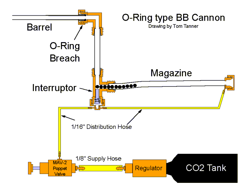

Here's a pic of a system from [url]http://bb_ops.tripod.com/RC_Combat/RC_Combat.htm[/url]
I tried this successfully, but I modified it and put the oring breach on the interrupter. In your case, you may want to eliminate the interrupter and use a coil to hold all your bb's. Place the O-ring breach at a point just opposite from where the interrupter pin is and eliminate the pin.

- RC battleship cannon configuration
- bb_guns1-s.gif (20.26 KiB) Viewed 5000 times
