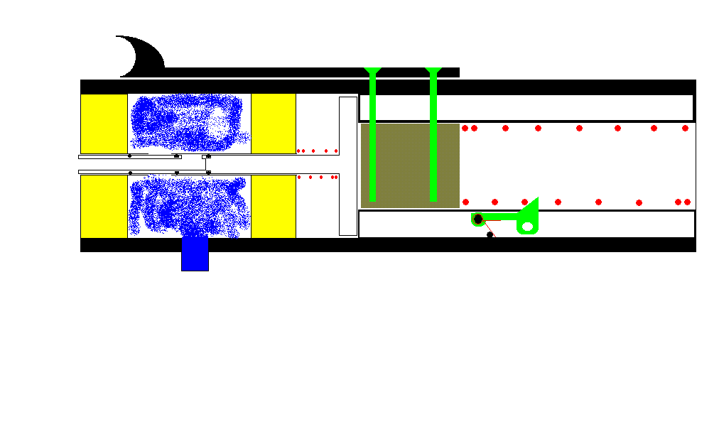

anyways, ive had a slow morning so i got on paint... this is what ive basically decided on for my similar project... hope it helps...
the larger spring in the back is a 1" spring and is housed in a normal sch40. PVC pipe.  the over all larger pipe is a sch80 pvc/abs pipe.  The psi rating on sch80 1.5" is about 300-400 psi, well over what i want to be operating at.  this is a picture of the system at rest.
