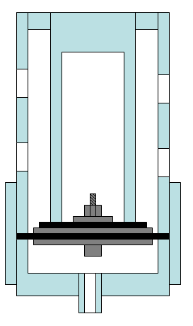

excellent work on the prototype, chamber sealing diaphragm valves much I've only seen it on certain commercial valves
well you know how on most barrel sealing diaphragms people typically put solid backings around the center because pressure tends to want to push the diaphragm out the barrel so typical barrel sealing diaphragms, well a chamber sealing is even more tricky because the area around the center has to be thick enough to endure the pressures, so typically diaphragms aren't supposed to stretch much at all
you ought to order some sheet neoprene or this purpose or layer up the diaphragm, here's another construction diagram that should help limit the stretchable area of the diaphragm (once I get it uploaded)
edit: here's the diagram, sorry I could get it sooner I was at home for spring break and the internet at home has been annoying
reenforced diaphram cartridge.PNG (5.04 KiB) Viewed 1757 times
