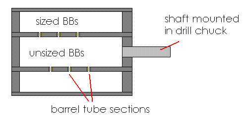

In the US you're more likely to find 1/16" and 1/8" tubing and bearings so it might be worth looking for those dimensions.
I was thinking about getting 1/16" tubing to avoid jams but that works out at around 1.5mm, most of the BBs seem to be true 1mm diameter according to my vernier so I can't afford that sort of blow-by at this scale, it would be like using 6mm airsoft BBs in a 9mm barrel :roll:
I was thinking of conjuring up some sort of coaxial attachment I could fit into my drill to size the BBs quickly:

jackssmirkingrevenge wrote:In the US you're more likely to find 1/16" and 1/8" tubing and bearings so it might be worth looking for those dimensions.
Only problem i see there would be how to get the sized bbs out. And that would allow the perfect and the too small bbs to fit through. Although i have to admit that is a really good idea.

just thread the side of it and put a bolt in it

JDP12 wrote:just thread the side of it and put a bolt in it
I guess that would work but still would take quite a bit of effort to get the bbs out, but then again they are 1mm. It reminds me of a video i saw of a guy who used a water bottle filled with airsoft bbs and soapy water to clean his bbs.

I could easily make a threaded cap in the main tube that also seals the inner tube, shouldn't be too much of a chore.
