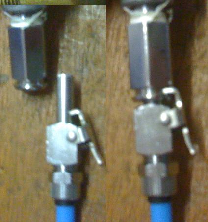

Crna Legija
Posts: 2333
Location: australia
Wed Dec 01, 2010 11:18 pm
iv have used QC at 600psi but they are near impossible to remove passed 300
iv switched to using these:
more_eggs
Posts: 179
Joined: Sun Nov 21, 2010 7:48 pm
Thu Dec 02, 2010 12:07 am
Hey they look pretty good..
Do they stop air from passing through whilst not connected? Expensive?
Crna Legija
Posts: 2333
Location: australia
Thu Dec 02, 2010 1:02 am
yea both halfs have a check valve in them, idk how much they cost all what they are called i get them free from work.

Thu Dec 02, 2010 1:06 am
I just called up IFS down the road and asked for something like them.. They had a nitto fitting which was rated for 700psi, but it was $47 and $20 for the other side connection :(
Thats a bit out of my price range unfortunately.
When you say near impossible to connect, how hard are we talking? Like no chance I would get it off safely at 600psi?
