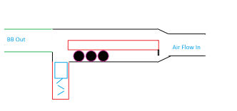

I am having some issues with the magazine feed and am looking for suggestions.
My original design used a horizontal mag under the barrel with a spring loaded feed but I am not happy with it.
I tried a simple T-breech but to get any decent capacity I have issues with the length of the spring required. The same goes for a bottom feed mag, i still need a spring that is too long.
I am leaning towards a gravity feed magazine from the top and then using the solenoid to push the round sideways into the airstream.
The problem I see with this idea is the round will then have to travel through a 90 degree bend to enter the barrel.
Another idea is to use a mag on a 30 degree angle from the rear of the stock that intersects the barrel / breech and use a pull solenoid rather than a push. That means the breech would be blocked in the normal position, then the solenoid can retract allowing rounds to flow. That of course means continuous fire as long as the trigger is held down, rather than the single shot concept of my original design.
Any thought appreciated.

evilvet wrote:Hi
Replying to own thread.
Not good.
Need to get out of workshop.
Anyway................
Could this work ?
Instead of using springs to keep the mag pressurised, why not use air pressure?
Lower chamber holds the rounds, at rest they can rattle around and the solenoid plunger is in the lower position.
I use a two stage trigger pull, the first opens the air valve and pressurises both the barrel and the mag. Rounds are pressed forward, one is now resting above the plunger.
When the second stage trigger fires, the plunger rises, pushes a round into the air stream and fires.
Release the trigger and the system is at rest.
Yes I use a lot of air but I am running this from a 40 litre fixed tank so I don’t mind so much.
What do you think?

Why not?evilvet wrote:I am leaning towards a gravity feed magazine from the top and then using the solenoid to push the round sideways into the airstream.
sounds like it would work well feeding from a hopper.
Yeah, I get you (I think)
Side mount the solenoid and offset the magazine ?
The slope will also act as a detent and stop misfeeds ?

Basically, the solenoid pushes individual BBs into the barrel, it would be good to have some sort of detent between the magazine and the hole in the barrel though, or at least a magnet or similar to prevent misfeeds, better than just the slope.evilvet wrote:Side mount the solenoid and offset the magazine?
