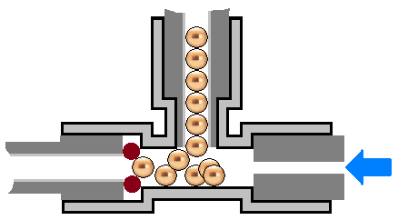

Is it worth it? What are the benefits?
Proportions are important:
- teemod.png (4.4 KiB) Viewed 1767 times

Incorrect, the T fitting i am using is 1/4" NPT. The BBs fit perfectly, without any modification.Proportions are important

you should go up to 3/8 or 1/2'' to alow air to flow around the bb behind the one stuck in the dent.Pneumaticology wrote:Incorrect, the T fitting i am using is 1/4" NPT. The BBs fit perfectly, without any modification.Proportions are important

I will have a look at the T piece, as it may be that only one BB can fit in the 'chamber' with none behind it. It is an amazingly tight fit, almost like it was made for it.you should go up to 3/8 or 1/2'' to alow air to flow around the bb behind the one stuck in the dent.
