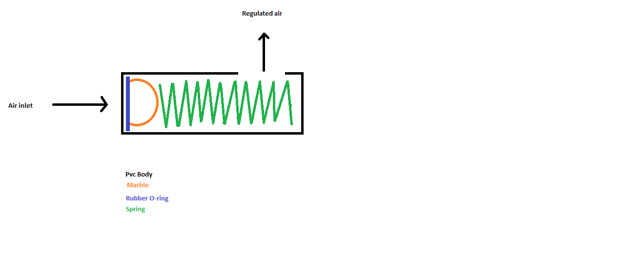

Could you use something like this for an air pressure regulator?
Homemade Regulator.png (13.26 KiB) Viewed 3801 times

No. To regulate pressure, the spring needs to be opposed by downstream rather than upstream pressure.
This is an animation I did some years ago to demonstrate the basic principle:

So you tighten the spring for higher pressure?
Sat Feb 01, 2014 7:47 am
Andrew_J wrote:So you tighten the spring for higher pressure?
That's how most regulators function.
