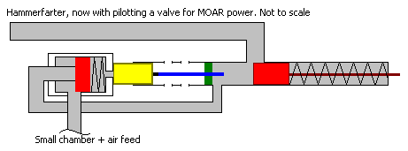

EDIT, diagram added:
Hammer strikes on the blue pin, which strikes shrader (or other hammervalve).<br />The rest should be self-explanatory.<br /><br /><br />MOAR power!
MOAR power!

psycix wrote:I dont thing the magnet damping is a good idea. Losing any more energy may stop the cycle.
I said that by my own admission.
I was just listing ways to alter resonant frequency, of which damping is one and I wanted to give an example of how it could be done, so it fitted with the more solid "heavier hammer" and "longer overall spring length" suggestions.

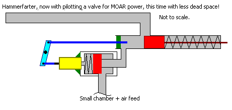

Modified the diagram, this time with a lever to make sure there's way less dead space.
The lever could also be used as a transmission, being able to use a mechanical advantage.
