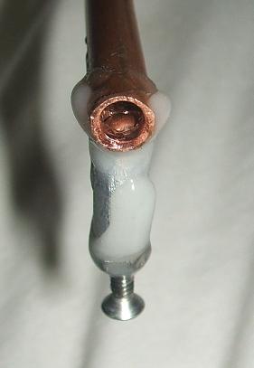

I've taken a break from auto-pistons for the time being and decided to prototype this design, here's a little photo of the work in progress. It's being held by araldite for the time being but it now needs a chamber and the casting will also reinforce the detent mechanism. Who knows, this might achieve DAKKA DAKKA DAKKA! using much less mechanical complexity :)

I would have mounted it onto the top, that way the bb won't fly into the ground.
I took the photo at that angle to show the ball detent, it's top-mounted in the chamber. Testing to be carried out in less than 24 hours ;)
edit: just realised I hadn't updated this, testing wasn't a huge success in that the rate of fire was still too high for individual projectiles to be discerned, so much for "dakka dakka dakka" :roll:

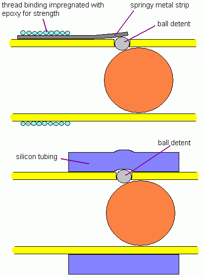

Wed Feb 23, 2011 1:29 am
I've been experimenting with different ways to add detents, these are a couple of systems which I found to work well. The first one can be adjusted for strength by altering the proximity of the end of the binding to the ball, the closer it is the more pressure needed to pop the projectile. The disadvantage of this method is that some air is lost past the detent on firing, but in practice this should be negligible, all the more so if the breech is inside a BBMG chamber and there's pressure keeping it shut.
The second system is not really adjustable (unless you have different types of tubing to play with) but it prevents air loss past the detent.

Wed Feb 23, 2011 8:35 am
wouldn't the ball just fall out?
Wed Feb 23, 2011 8:51 am
Have you tested the system that I use? (a rubber washer sandwiched between two threaded fitting)
Posts: 3643
Been thanked: 62 times
Wed Feb 23, 2011 9:22 am
-_- wrote:wouldn't the ball just fall out?
Notice the stepped hole. The part most of the ball sits in has a larger inside diameter than the very bottom of the hole (where the "active" part of the ball pokes through).
Easy enough to do with two drill bits and a drill. Even easier with a drill press. :wink:

Wed Feb 23, 2011 9:35 am
ahh yea wasn't looking hard enough
Wed Feb 23, 2011 10:55 am
Mark explained pretty well why it wouldn't, and how to make the right hole ;)
Yes, and I think that is the best way to go about it. An o-ring detent is easily adjustable, servicable and provides projectile retention and and airtight seal.
