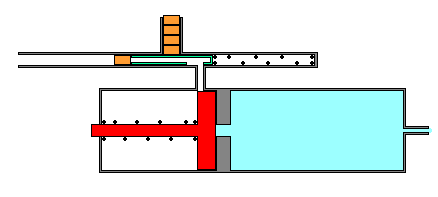

You guys make valid points but somehow I'm not convinced this is worth pursuing. I've been thinking of going back to the pop-off valve, maybe combined with a blowback bolt, something like this:
- popoffblowbackani.gif (12.33 KiB) Viewed 3038 times
When air leaks past the hammer you lose pressure.
When there is an projectile, the pressure will need to be there much longer and thus the leaks become more significant.
JSR, dont throw it in the failbox yet! It should be able to work!
