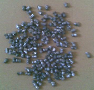

On another note, I'm questioning the wisdom of using lead pellets. I went through quite a bit of lead this morning, not cheap even for shitty brands and definitely not reusable. Maybe BBs would be a better idea to keep running costs down.

edit: I limited piston travel to 3mm, which for a 10mm port is more than enough flow considering it exhausts through a 5mm tube. Pellets were travelling some 50 fps slower than an unrestricted piston, I'm guessing the energy lost compressing the spring is compensated for by the increased piston momentum and therefore dwell time.
This morning's lead consumption:

Methinks you might be better with BB's lead costs a lot, unless of course you melt it down and find another use for it.

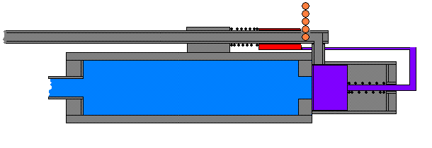

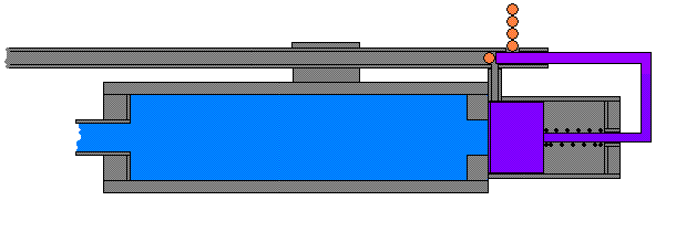

why not make the "pop" piece actuate the bolt?
seems like it would be easy enough.
Something like this?

jackssmirkingrevenge wrote:Something like this?
Precisely hahaha. I feel like your attempting this as we speak.

VH_man wrote:Precisely hahaha. I feel like your attempting this as we speak.
Not just yet. In that design, by definition the bolt is not closed when air starts getting into the barrel, I need a better solution.
Hmmm...
