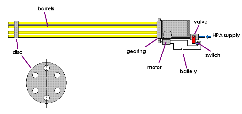

I'm giving serious consideration to the Gatling idea, basically a vortex block BBMG with spinning barrels - not an innovative concept but I haven't seen it done yet. One thing I'd need made is the barrel disks as they have to be precise and I don't have the facilities for such small scale precision, any takers?

Gatling good, it would be more about a cool little project (that the small calibre makes feasible) than attempt to change performance.

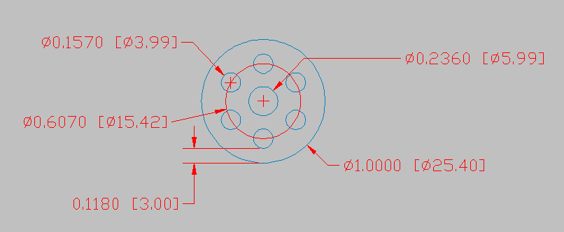

If you were to take two discs..drill a hole in the center and then insert a bolt through them...
You could rotate it with the bolt as the center.
Put it under a drill press and all holes will be equally spaced from the center.
All you need to do is draw on the angles to space them evenly far apart.
Ofcourse you would need a drillpress with one of those tables attached to fix the bolt....but it's not that hard..

Back on topic, you might want to look at the technique for laying out adapter plates for lathe chucks. Basically you scribe a circle of whatever diameter, and use a prick punch on a random point on that line. you plug in the angle and diameter into a formula (too lazy right now)and get the linear distance between centers of the holes. you then go around the circle, marking with the scribe and prick punching. If you made it back to the start point, good job, center punch and drill. if not, scream, cuss, and try again... :D I would countersink the holes somehow, so it would feed better. Might jam though...

Gents, got it. I guess 5.5 tons would make it big.... :oops: I did a Cad drawing of the dims and they look like they need to be tweaked. I can also machine a block so the barrels don't twist around the center axis. Yes, we can make a lot of them if needed.

Cheers :) you were right about the dimensions being wrong, disk O/D should be 1", not 0.75".
I only need about 3 but who knows, I might start a trend :)

jackssmirkingrevenge wrote:Cheers :) you were right about the dimensions being wrong, disk O/D should be 1", not 0.75".
Recall, I got Duane's stuff to do also :oops:
