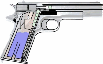

An airsoft mag usually looks like this.
The green is liquid propane. A hammer hits the purple button, which opens the valve (yellow) for a shot. You could use a schrader where the yellow is. You could fill the chamber to say 400 psi with a shock pump.
When you insert the mag, the schrader goes into an o ring. The chamber can now be vented by a blow gun.
Or you could just have an onboard chamber like i did.

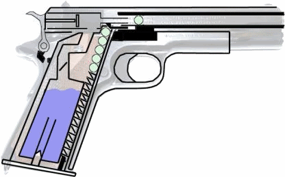

Thu Sep 30, 2010 9:57 am
jackson pollock wrote:An airsoft mag usually looks like this
Have a slightly less modern art version :)
