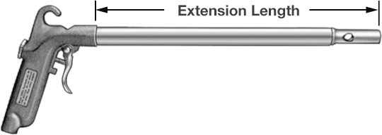

turbohacker
Posts: 392
Fri Jul 20, 2007 1:20 pm
Why not use a vale like this?
