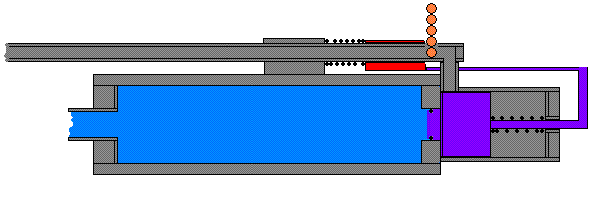

I don't think there is any point in using a bolt on such a small bore... david's idea to use a hopper seems quite good... besides in this way you could just buy a ready made magazines (yeah I know.... heresy)
ohh I really like the diagram.... putting the magazine before the air inlet seems like a quite a good way to get rid of most of flow restictions... plus it will give you a very modern bullpup design :wink:

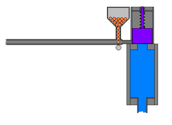

POLAND_SPUD wrote:I don't think there is any point in using a bolt on such a small bore... david's idea to use a hopper seems quite good... besides in this way you could just buy a ready made magazines (yeah I know.... heresy)
I agree that it would probably work with just a hopper as in the attached diagram. You'd need a detent/o-ring/magnet to stop the BBs rolling out but it should work well. There will of course be dead space in the magazine but the BBs in the hopper tube should provide enough flow restriction to mitigate this, and the fact that each burst of air will agitate the BBs in the mag means it shouldn't jam.

The second design on the previous page doesnt solve the problem of the first one.
Allow me:
Problem -- Bolt was open when valve opened.<br />Solution -- this:
Solution -- this:

psycix wrote:The second design on the previous page doesnt solve the problem of the first one.
Allow me:
I would have thought this would be a good compromise. If you can balance the spring weight and the mass of the piston well I'd have thought most of the air would head out the barrel. Only thing I can see being a problem is it pushing a BB up into the hopper/mag and it not dropping down before the bolt returned.
Then again, maybe a straight hopper is easier.

SPG wrote:Then again, maybe a straight hopper is easier.
Exactly what I'm making at the moment, with a groove in the barrel for an o-ring detend and a PET preform as a hopper, convenient cap for filling and clear so I can see it in action :) It should hold around 200 BBs easily.
