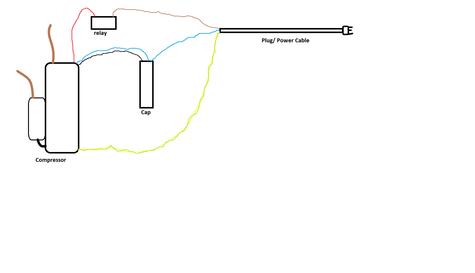

Alrighty..
So iv pulled the aircon unit apart and Im trying work out the wiring.. I have it all figured except for one part..
So coming from the wall socket, I have a Green and Yellow wire (ground), a blue wire (positive?), and a brown wire...
green wire obviously mounts to the base of the compressor, blue wire runs via the cap then on to the the compressor..
but this brown one is the one that is tripping me up.. The brown wire runs into one of these
http://doc.chipfind.ru/omron/g4a1ae.htm
then out of that comes a red wire which runs to the compressor. Obviously it is a relay of some sort, but do I need it, and what does it do?
Here is what I tried to explain above
Rekon I can just eliminate the relay and run the brown wire straight to the compressor?

more_eggs wrote:im an electrical/mechanical engineer student by the way :)
then you'll know the brown is live while the blue is neutral ;)
I agree that eliminating the relay should work, however I know next to nothing about 'lectricity :D
Haha so far we have only been working with more computer based stuff (microprocessors, PLD's, programming etc etc).. I think your thinking of an electrician :P
Hmm well Ill take out the relay and see if it runs :D
more_eggs wrote:I think your thinking of an electrician :P
Or anyone else who's ever wired a plug ;)

Hahaha I usually go with the good old guess and check method :P
EDIT: IT WORKS!!! :D I can has a working compressor..
