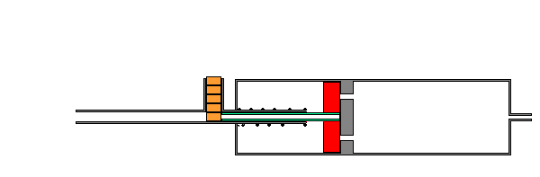

jackssmirkingrevenge wrote:You guys make valid points but somehow I'm not convinced this is worth pursuing. I've been thinking of going back to the pop-off valve, maybe combined with a blowback bolt, something like this:
Jack why bother with a seperate blow back bolt, you can just go for a combined system, which I dub the "pop off bolt"
Voila.

SPG wrote:Jack why bother with a seperate blow back bolt, you can just go for a combined system, which I dub the "pop off bolt"
That does does have a problem, in that the breech is barely starting to seal when the valve pops open.
Trying to fix that issue may then cause "the farting problem".

It's no different than a BFB by itself.
It won;t work

You need a stepped piston with different diameters and o-rings.

psycix wrote:You need a stepped piston with different diameters and o-rings.
SPG's design is a stepped piston, in that the area of the ports is much smaller than the area of the piston.
The idea is similar to what I had done here
If the porting out of the chamber is much bigger than that going into the chamber, there shouldn't be any flatulence problems.
After all, no farting here ;)

It was just a quick rough sketch to show how it could be linked to the breach.
I'm never certain why Jack goes down the seperate breach route it looks to me like trying to balance two seperate air/spring systems could be a nightmare, one is bad enough. But equally well he could use his design but link the piston to the breach mechanism instead of going for blow back.

We could use a rotating bolt and use the rotating bolt head as the valve. Still, flow issues, but seems OK none the less.

SPG wrote:it looks to me like trying to balance two seperate air/spring systems could be a nightmare, one is bad enough.
Personally, I'd say it's more likely to be a nightmare doing it with just one. Either way, there are two systems to balance, the valve and the loader. Trying to solve them with just one spring system will mean any changes to one will automatically affect the other.

I really like this design,:
But I think it could be simplified (Greatly)
For one the entire barrel or internal barrel sleeve could move backward to strike the valve.
That way the spring could be mounted (externally from bolt) at the end of the barrel (perhaps inside a flash suppressor looking shroud or somewhere along the barrel).
Also the trigger (sten gun lever type) could be fitted any position along the barrel (or sleeve)
For simplicity also, The back of the barrel would be blocked off and the gas would flow through holes in the sides of barrel rather than breech.
(Same as diagram shows)
The blocked off back off barrel would strike the valve,
RATHER than a blocker pin, a pipe the same length as blocker pin would be fit externally over barrel and vent holes (rather than internally).
I was stuck on ammo feeding with this design but it could feed at the same position into a slot as a solid blocker pin and seperate loader tube!!!
Course rate of fire/bounce will probably be so high it will need a strong mag. spring or even pressure loaded mag (a cloud for magazine).
