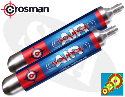

Use one of these on the bottom of your gun, it is disposible, readilly availible, and small. I also think it would last plenty long for your particular gun. (problobly a couple of chainbers full)
- crosman_co2_cylinder88.jpg (29.33 KiB) Viewed 5319 times

turbohacker - any idea what type of thread that is, or where i could get an adapter for those things. also what type of gun uses those?

This is used for low buget paintball guns (walmart specials
They can be baught at many large department stores as well as paintball shops. Here is the only adapter I could find, however I have seen people drill a hole in the side and tap ordinary pipe threads into them.
The only problom with this idea is that you would have to incorperate a regulator into your design because I doubt your blow gun will handle over a thousand PSI.
http://www.apsram-usa.com/index.cfm?fus ... duct_ID=40
You could use this small regulator because it hade pipe threads already.?
http://cgi.ebay.com/Tippmann-98-C-Gun-P ... dZViewItem
EDIT: These CO2 tanks are also used for air rifles.

You should try using the co2 tanks that turbohacker suggested, I think they are four ounce tanks. (They are also used for bb guns.)
- paaiyan
- First Sergeant
- Posts: 2140
- Location: Central Oklahoma
Yea, those 88g things would work for you I think. They aren't obscenely large, and they're fairly cheap, last time I checked Wal-Mart had them.
