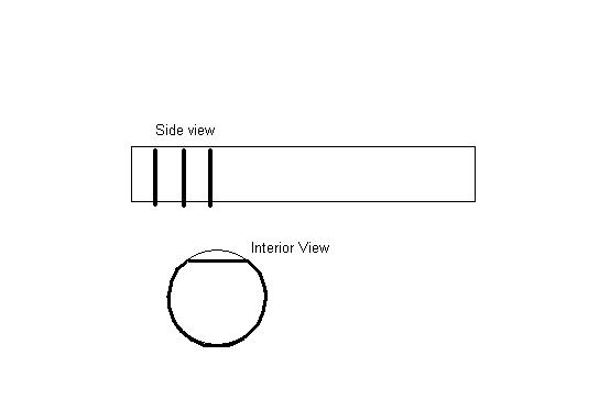

I've thought about this, too (only for paintball). The best way I've figured it would be to put a small laceration into the top of the barrel, near the breech. Then obtain o-rings to fit in these slits and place the o-ring in such a way so that part of the o-ring is actually in the barrel. I've included a diagram to help better understand it.
This is actually not my idea.  A discussion came up a while back about it.  I just incorporated it for use.

so that would work because of friction between the bb and the o-rings? so the o-rings would wear over time.

The o-rings probably would wear over time, which is why the o-rings should be replaceable.

hmm could get fiddley in a 6mm barrel, i would prefer using my idea (if it works) because it would act as a silencer too because my barrel will be inside some 15mm pipe.

Yeah, it may be hard to accomplish using that size barrel. However, your idea seems more like normal porting. I don't know how effective it's going to be in creating hop-up. It may work, but I don't know.
