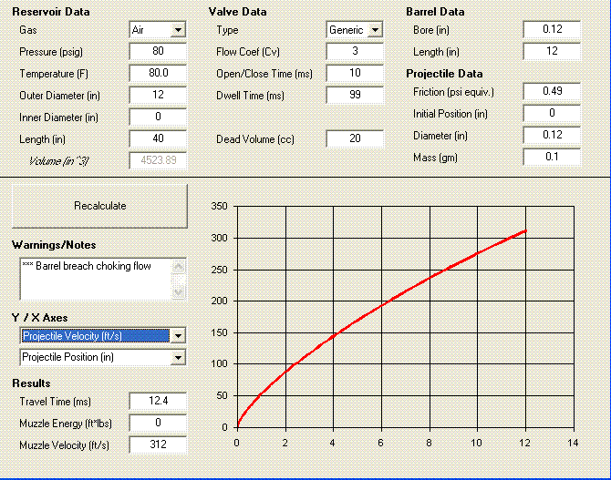

I can work all that out for you with GGDT if you like?
I'm not sure if 3mm has been done, but I know JSR has made a pen-sized pnuematic gun which shot tiny lead shot.
It can be done and would be a good alternative to shooting x-mas decorations as ammo for the OZ spudder.
EDIT:
Right there for you mate. I had a burst disc as an input as I wasn't sure if generic" means blowgun as the valve.

JSR actually used a 2.5mm barrel and found that even with 300 psi and a piston valve, the lead shot was barely able to penetrate a sheet of paper.I'm not sure if 3mm has been done, but I know JSR has made a pen-sized pnuematic gun which shot tiny lead shot.
However, as a BBMG it might well work - most BBMGs have woeful single shot power, but with a good rate of fire that translates into serious damage. I would recommend using something longer than a 12 inch barrel though.
IM, there's no way a 3mm ball bearing weighs 5 grams
- 3mmBBMG.GIF (24.82 KiB) Viewed 6712 times

312ft/second aye jsr, tht aint too bad is it?, what if i were to have 20mm endcap joinng onto a male thread > 20mm ball valve (spring actuated) >male thread> Reducer> epoxy reducer> barrel?
Then just make it a single shot, or would this make the barrel become the projectile, or if not 20mm what size?
and just make it a single shot, would it be more powerful?

If you're making it single shot, then a blowgun would be sufficient as a valve - I find blowguns have sufficient flow for a 6mm barrel, so a barrel with 4 times less area should be a doddle. You would of course lose the multi-shot benefits of a BBMG, meaning you'd want a lot more velocity out of your projectile - so if I were you I would look into getting myself a MTB shock pump and finding materials rated to 300 psi or more (your fellow Aussies on here will help out I'm sure, particularly Mitchza89 ) as well as using a long barrel as suggested earlier.
