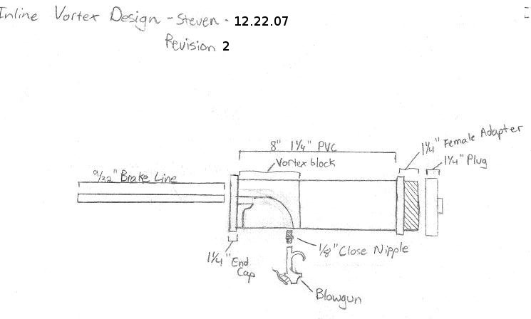

Below is my design for an inline vortex. Tell me what you think.

12.22.07: Added Revision One as attachment; added Revision Two
Revision Two
Revision Two

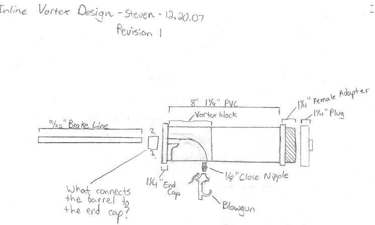

Revision One
Revision One
inline vortex design.jpg (26.92 KiB) Viewed 5450 times

... Click on it? I can and it gets bigger. If it doesn't, here you go.
Inline Vortex Design
inline vortex design.jpg (26.92 KiB) Viewed 5554 times

It looks to me like it is just a basic inline vortex setup.

What do I use to connect the barrel to the end cap though?

spudbud101 wrote:What do I use to connect the barrel to the end cap though?
Your imagination :wink:
You just get a compression fitting the diameter of the barrel, chuck it on and then drill a hole in the end cap and thread the other end of the compression fitting in. Or you could solder a fitting on, or epoxy a fitting on.

Spudbud, that is why mankind created drills and epoxy.Sometimes you just have to make your own fitting.

And as far as i can tell, where you connect your blow gun to should be the air input. So turn it 180* around, and run the air thru the gun to a fitting so you have a trigger.

Did I draw the blowgun upside down?

spudbud101 wrote:Did I draw the blowgun upside down?
Yes

i can see it now an it looks like it will work, maybe you could try something new and make a really small vortex block and bb chamber for better air effeciency or something.
