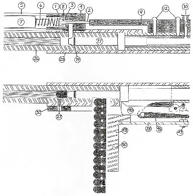

Does anybody know how the caselman airgun recycles?

After reading and looking at the diagrams I still dont get why the caselman is an automatic. It works partly like a spyder paintball gun but the gas is not ported out the back of the valve.

is it a gas-blow-back-bolt? where the High pressure air recocks the mech?
Thu Jan 17, 2008 4:04 pm
thread about it here

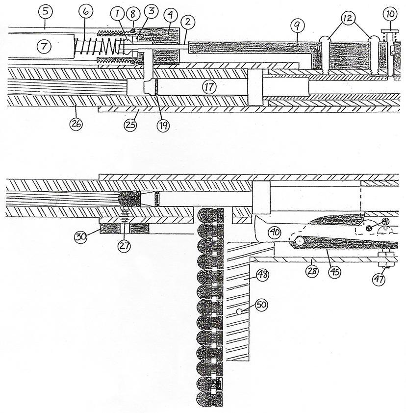

The hammer (9) strikes the valve stem (2) which allows a burst of air into the barrel between the projectile and the bolt (17) - this fires the projectile and pushes the bolt back, recocking the hammer and allowing the cycle to continue, unless the bolt is caught by the trigger sear.

jackssmirkingrevenge wrote:thread about it here
Ah you already posted exactly the same lol. I guess ill take mine off in some time. Thnx for explaining though. As u said in your other post, this mechanism prob only works under high pressure. The projectile needs to have lots of friction with the barrel inorder to recock the hammer. I think it also has to do with mass. As most ppl here are using platic bb pellets, this gun doesnt seem feasable for our level or building''. The lower mass projectile would give little reaction force to the hammer.
Thu Jan 17, 2008 6:09 pm
In the case of the caselman, the surface of the bolt on which the pressure is acting is identical to that of the projectile - since we're working with lower pressures, we need a larger area to get more force from the pressure, enough to recock the hammer.

jackssmirkingrevenge wrote:In the case of the caselman, the surface of the bolt on which the pressure is acting is identical to that of the projectile - since we're working with lower pressures, we need a larger area to get more force from the pressure, enough to recock the hammer.
Well but we also need less force to open the valve. So all in all its the same. I thought about it before, the physics of automatic fire. When u look at impulse the P*A*t has to be bigger than the m*v of the hammer. (P is operating pressure, A is area of the hammer, t is dwell time, m is mass of the hammer and v the velocity when it hits the valve). Then the hammer also has overcome a certain force to open the valve. This is m*a ( of the hammer) which is m*(v/(m/k)^0.5) which has to be bigger then the the P*A of the valve (k is the spring constant of the spring behind the hammer).
As though I thought about this all and kinda have it on paper I cant really put it to practice as I dont know the spring costant of my hammer spring and friction matters. Also in the formulas above I havent taken into account the spring behind the valve.
Coming back to the caselman. We can take that the area of the hammer is the same as in our guns (bb ball size) only the pressure is higher but to compensate this high pressure you need a high hammer velocity which in turn means there is more energy in play''
As I said before I think it has to also do with the mass of the bullet. By law of conservation and inertia, a heavier projectile will exert more reaction force on the bolt.
