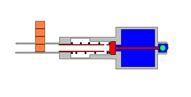

I've made several attempts at a blow forward breech that would cycle automatically as long as there was airflow, however so for my attempts have either resulted in a valve that hangs open or cycles so fast it's impossible to reload ammunition.
Following the logic that's been developed with the auto-piston discussions, it would appear to me that the simple solution would be to add a check valve that could cut off the flow once the bolt starts moving forward, with the added provision of a firing chamber holding enough air for a good shot.
Opinions, comments?
making the blow-forward breech work
- Posts: 26220
- Been thanked: 352 times
- bfbreechmod.gif (16.59 KiB) Viewed 13074 times
- ALIHISGREAT
- Staff Sergeant 3
- Posts: 1778
- Location: UK
yet another complicated design from JSR
well i suppose it could be made to work but depending on the operating pressure you might need a pretty heavy bolt to be able to open the check valve for long enough to get some good power.

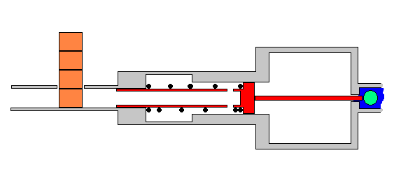

It could be slightly modified like the diagram below, this would effectively combine the "pop-off" effect in the auto-piston while using the piston motion to directly work the bolt and seal the breech.

how would you start it cycling though? because if you turn on the air the check valve might just close instead of enough air getting through to push the piston forwards.

To be honest I don't think this design will work very well. It does not seem like the bolt will keep the check valve open long enough to fill the chamber to a decent pressure, unless the check valve is high flowing and the bolt has some weight to it. Even then I think it may just not work.
If you increase the weight of the bolt you need to have a stronger spring and for a stronger spring you need more air pressure, which will result in the check valve being harder to open.
You might get it to work though.

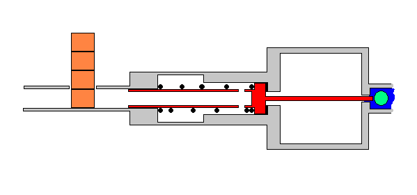

Altered the animation slightly to suit a pop-off style bolt - this way, it doesn't make a difference what flow you have in the chamber, it will always work (though changing the flow alters the rate of fire)

yeah that has more chance of working... but it would be a bit faffy to get good performance because of spring strength etc. and a high operating pressure.

Indeed, spring strength will be critical.
But I like it.

That is very clever but I think it would cycle too slow for it to be worthwhile but that depends on the amount of flow going into it and I dont know where you would get the extremely strong spring that would be required.

Hey jack, this design is similar to that I came up with in my P.4 project. In my case the barrel is moving as well, which makes things a bit easier in my case. I might step to ur internal moving part as well, but the problem is finding a spring that fits inbetween all those pipes.
My animation made in interactive physics:
Picture:
So I am positive that this gun works. I have already tried to make it without a breech but again the pressure and the springs are hard to ballance. Hope to share some thoughts about this one as it more feasible for my technology''
Impulse of the hammer just before it opens the valve = m*v
Impulse the hammer needs to have to recock= P*A*t (P=pressure, A= area of the backside of the bolt, t=dwell time)
Inorder for autorecocking P*A*t > m*v
Then you have another factor; the hammer needs to open the valve first.
The Force the valve has = P*A
The Force the hammer needs to have to open the valve =m*a
a (acceleration of the hammer)= v/(m/k)^0.5 (k= the spring constant of the hammer spring)
So for a balanced airgun (autorecock) the hammer needs to have these properties:
P*A*t>m*v
P*a>m*v/(m/k)^0.5
(Btw this all formulae doesnt include the spring behind the poppet valve)
Now I hope this gives everybody some thinking space and hope for this design. Atleast we dont get to say now "it may or may not work". We have a certain boundaries where we have to be in and I listed those above.
